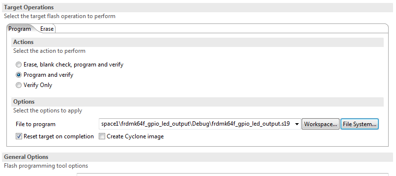

lpcxpresso_supp
Hi João,
One more thought on this topic...
If you only have a .bin format available then you can convert this to an srecord or intel hex file format and program this through the GUI Flash Programmer via P&E debug probe within MCUXpresso IDE. Simply invoke the GUI flash programmer and browse to the file via the File System (All Files) option etc.
Also note, programming an .axf file onto a board only programs the binary content of the file i.e. the contents of the flash will be identical either way
Yours,
MCUXpresso IDE Support

4,129 次查看
lpcxpresso_supp
Hi João Paulo,
Our current integration of the PE Micro debug solution only support the flash programming of .axf files.
However, LinkServer (CMSIS-DAP) and SEGGER JLink debug solutions do offer support for binary file programming. We hope to bring in this feature in a later release.
Yours,
