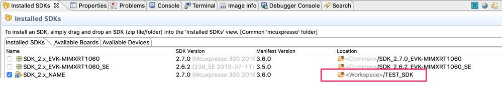

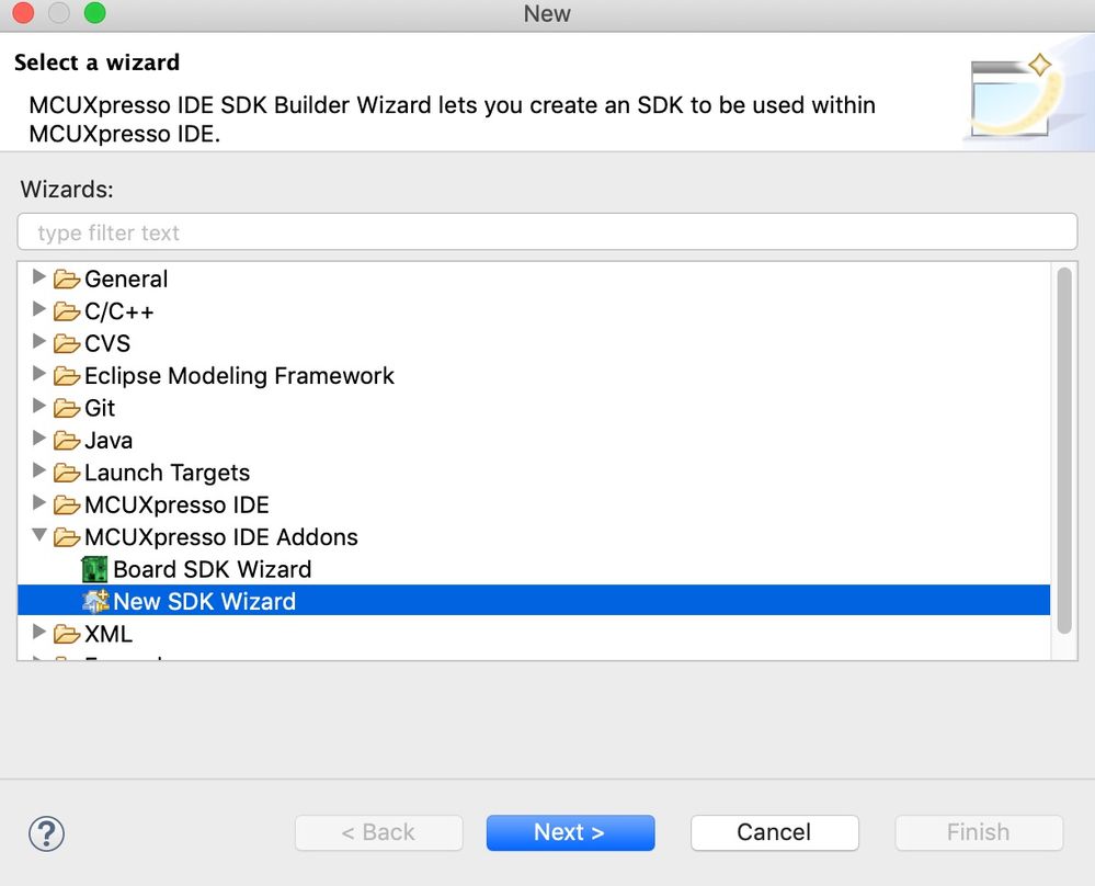

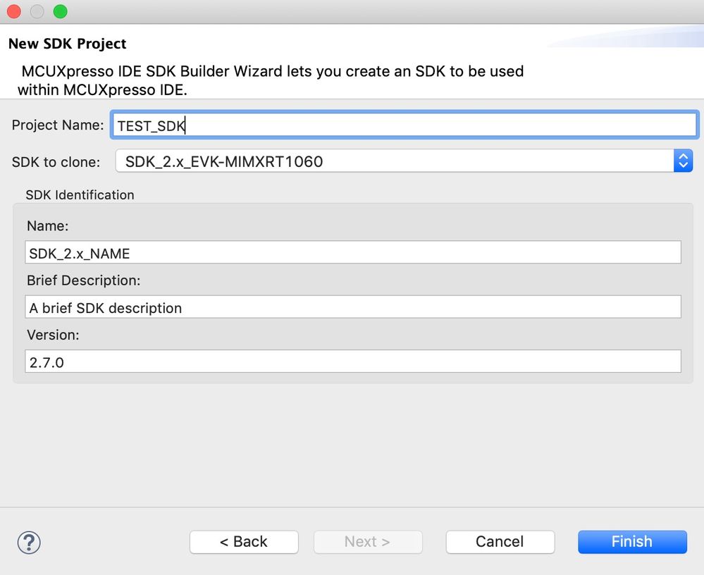

I have created a new custom SDK using the SDK Wizard.
I can see it available in the workspace as an installed SDK for new prjects, and this works fine.
Is there a "build" process to generate a zip file version of a custom SDK that can be placed in the default SDK location and used in any workspace?
Thanks.

That post seems to be old and not the same process as the new SDK Wizard.   The SDK Wizard only places the new SDK in the workspace (unzipped), not in the common folder.   If you switch workspaces, the custom SDK is not available.

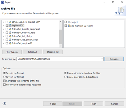

Indeed, the SDK Wizard puts the newly created SDK inside the workspace. You can simply export your SDK as a zip using File => Export => General => Archive File. Just like in the two screenshots below.
You can import afterwards the generated zip as any other SDK.
