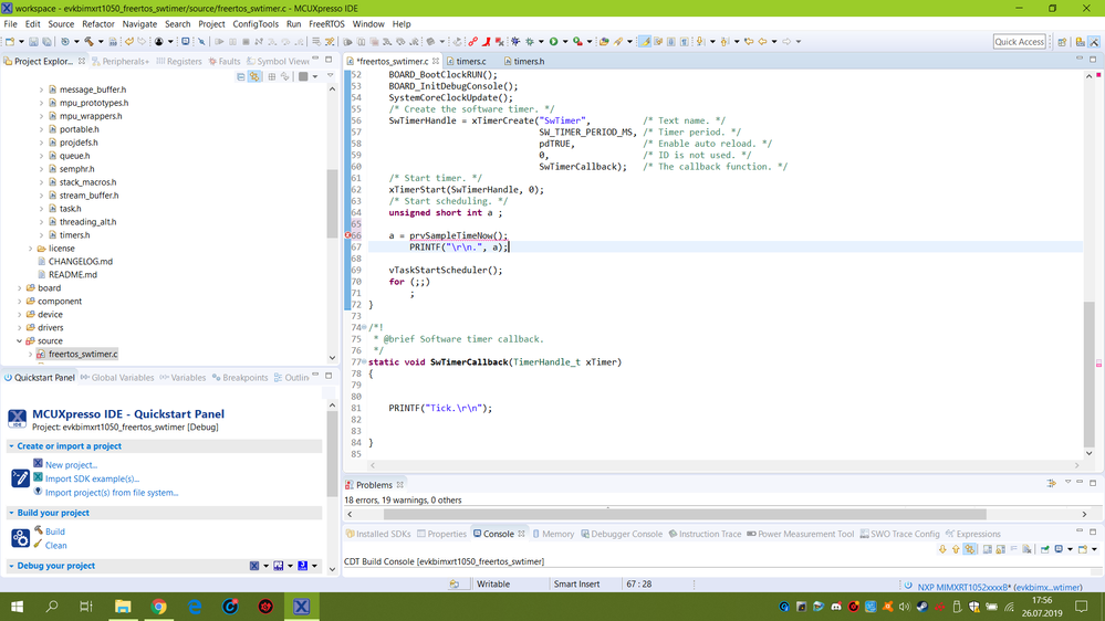

prvSampleTimeNow is a FreeRTOS internal function. You can see it is announced as static. It means functions outside timers.c can't call it.
RT1050 hasn't ctimer. But it has PIT, PWM and GPT. All of them are timer. Please refer to their examples in SDK.
I tried to get value from timer but cant use function prvSampleTimeNow(),

jingpan
Hi Omer,
No, you can't use it. RT1050 hasn't ctimer. LPC845's code won't work no RT1050. If you want to blink a led on RT1050 evb, please use iled_blinky demo in RT1050 SDK.
