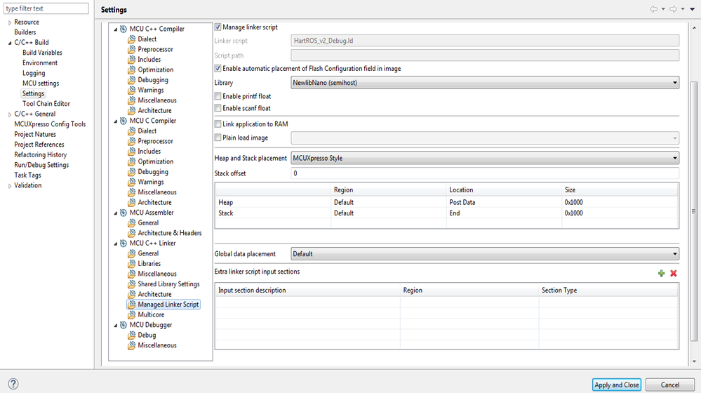

I am using MCUXpresso IDE v11.0.0_2516, the FRDM-K22F board and the FreeRTOS 9.0.0 port that comes with SDK.
In the application I am developing, I have no space for creating new dynamic data. So, the first step was increasing the heap size on "Project->Properties->C/C++ Build->Settings->MCU C++ Linker->Managed Linker Script" as in figures below.
The default value that is set is 0x1000 for the heap and 0x1000 for the stack. I set a breakpoint on pvPortMalloc, so I can see the first time that it is called. The "xFreeBytesRemaining" variable wich has the available memory remain is "10224" in first call.
However, when I tried to increase the heap size (let's say heap 0x1600 and stack 0x400) nothing happens. The "xFreeBytesRemaining" remains "10224" and application is stuck in same point.
Any tips on what is happening, and what can be done?
Thanks!

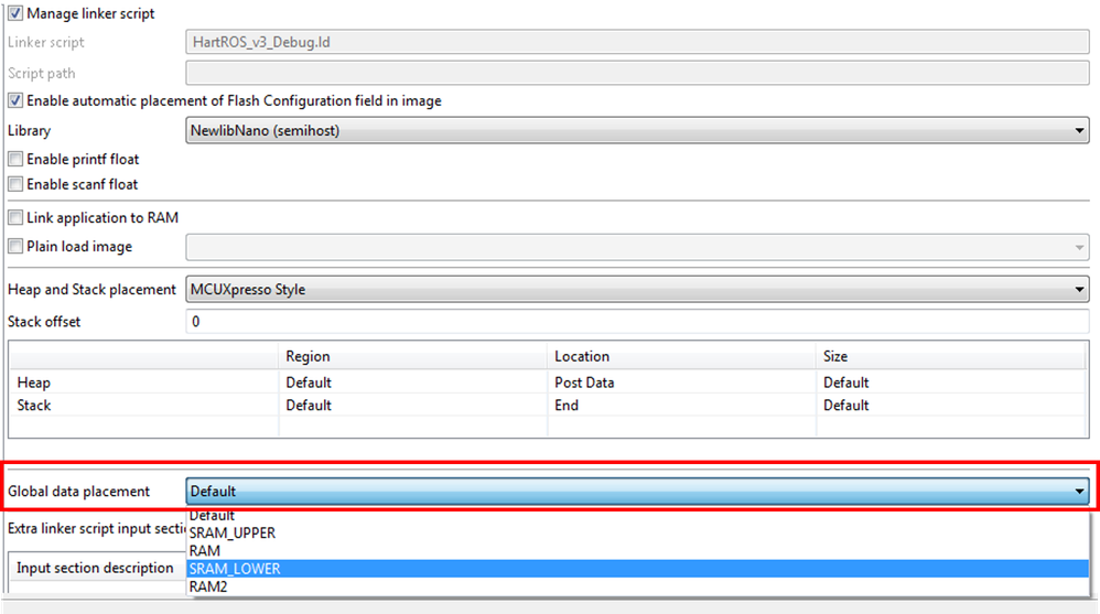

To get around this, my way out was to put the global variables (and hence ucHeap) in SRAM LOWER with all its space available for storage. For this, in "Project-> Properties-> C/C ++ Build-> Settings-> MCU C++ Linker-> Managed Linker Script" the "Global data placement" field was changed from "default" to "SRAM LOWER" as presented in figure below.
Now my program compiles correctly after increasing the heap to 51200 bytes. The memory usage output was as follows:

Since you're using a FreeRTOS-based project, your change will obviously not help. You're changing the heap size used by the standard C malloc whereas FreeRTOS uses its own memory allocation scheme. If you'll carefully inspect the implementation of prvHeapInit, you'll notice that the total heap size is set to configTOTAL_HEAP_SIZE (which is actually hardcoded to 10K in FreeRTOSConfig.h). This is what you need to change.
The initial stack size should be correctly controlled by the setting you mentioned. The initial MSP is set to _vStackTop that's depending on _StackSize. Check the linker script. Regarding the stack size allocated to a task, isn't that configured/specified when you create the actual task? I don't have much knowledge of the FreeRTOS code itself.
Greetings,
MCUXpresso IDE Support
