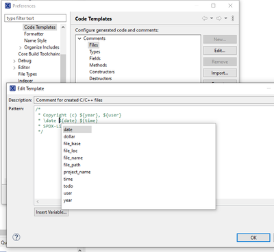

How to change he value of ${author} and how to add time create file ?

You can edit and configure this with Code Templates, see

OK, I can replace $author with a constant. But how do I set the value of $author ?

It is actually not ${author}, but ${user}:
Just wrote about it, see https://mcuoneclipse.com/2022/07/13/custom-user-with-c-c-code-templates/
