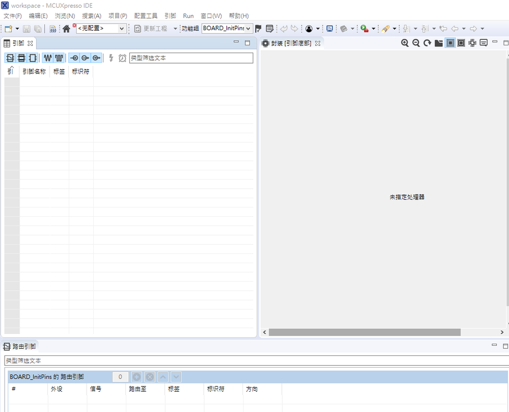

I use MCUXpresso IDE v10.2.0 [Build 759] [2018-05-15] , how to change  IDE language from Chinese to English ?

Note : The above language setting only applies to the integrated Config Tools. The main IDE is English only and cannot be reconfigured.

lpcxpresso_supp
What host computer OS and language configuration are you using? The main IDE does not provide any language settings - menus, dialogs, message etc are only provided in English. Can you share a screenshot?

samchen_tw
1. Windows 10 Professional

petrstruzka
Hi Sam,
if you have Chinese Windows locale, please add following lines to the end of mcuxpressoide.ini (you can find it in your installation \ide folder - like c:\nxp\MCUXpressoIDE_10.2.0_759\ide\mcuxpressoide.ini )
-Duser.language=en
(btw. to set it explicitly to Chinese, use -Duser.language=zh - simplified Chinese)
Petr

samchen_tw
Hi Petr
It works.
