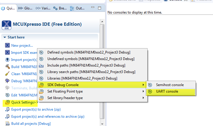

Dear Sir:
    Could you help to tell that how to Change the log display to uart terminal not the Xpresso console?thanks!

ZhangJennie
Go to IDE Quick setting, "SDK Debug Console", "UART console", we can switch output from Semihost console to UART console.

Dear Jennie Zhang:
多谢回复,我试了下,更改后在终端并没有显示,在console端也没有显示了;我用的工程师LPC824LITE的NFC样例工程,如附件,请帮忙检查下,是哪里出的问题,多谢多谢!
