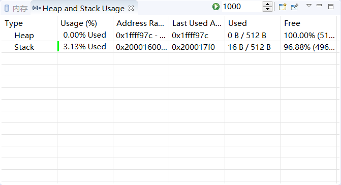

I am using MKL36Z64VLH4, with NXP SDK v2.0.4 and MCUXpressoIDE.
I write a simple PIT example. It has an blank main() which only have a infinite while loop in it. The PIT module interrupt CPU every 1 second and it blink the led in its IRQ handler.
This is the Heap and Stack Usage when in main():
But when the interruption happens and program enter the IRQ handler:
This is strange. I assume that this is because CPU does not reserver enough stack space when it enters the handler.
So when I started to do some complex things in IRQ handler, the stack just overflowed! How to increase interrupt stack size?

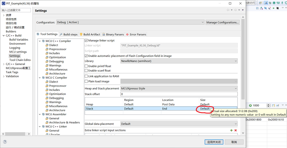

I solved this problem on my own.

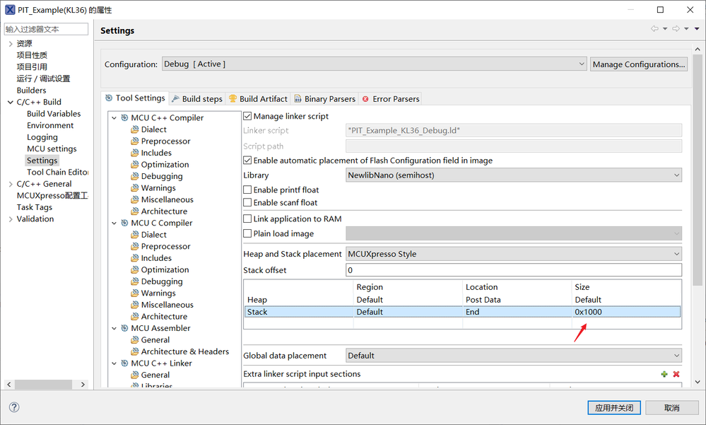

This problem is due to that total default ram size is only 512B (MKL36Z64VLH4 has 8KB memory). I didn`t expected that the default stack size configuration is such small. I set it to 4K and nothing goes overflowed now.
This is how I solved this problem:

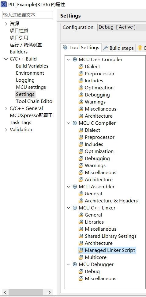

Projects -> Properties -> MCU C++ Linker -> Managed Linker Script
(default setting is only 512B)
(making it bigger may solve the problem)
