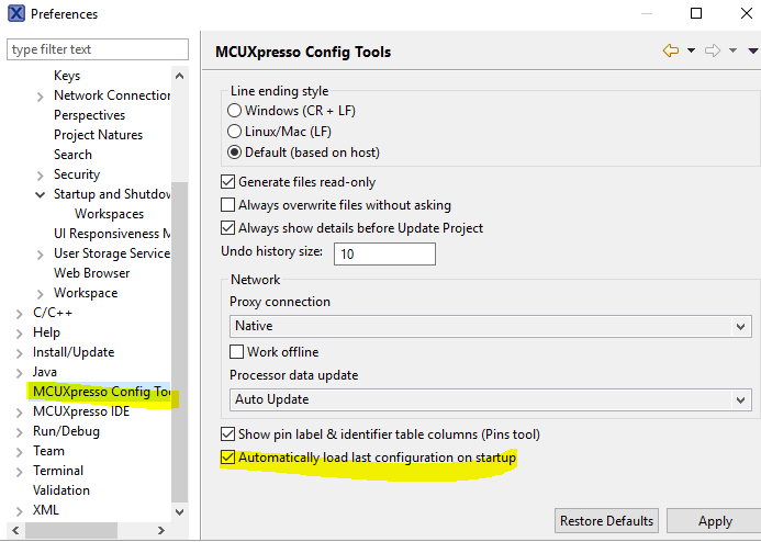

Everytime I startup my project (which was started by using example code), it tells me that the <project>.mex is different from the source file.  And I have to select "use the source" everytime.
It's incredibly annoying to do this over and over again.  I've searched high and low and can't find any doc or other forum posts that talk about this.
Therefore, it must just be me that has this issue... can someone please enlighten me on how to "unhook" the reliance on the MEX file?

liborukropec
Hello Steve,
the dialog warning cannot be disabled; if the mex configuration is not aligned with configuration stored in the sources, it shows the warning. Form what I read I understand that you are not interested in the tools anymore, so you can
a) rename the "mex" file file extension to e.g. "me~"
b) disable the automatic load of last Config Tools Configuration in the preferences:
Libor
3,393 次查看
netstv73
This is what I was looking for ... .thank you.
