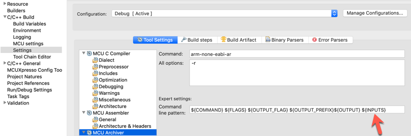

First of all, open the Project Properties for your library project, and open the Archiver settings:
What you can then do is replace the use of ${INPUTS} in the "Command Line Pattern" option, which is where the list of filenames effectively gets poked in, with a wildcard definition of your object files.
In your example, all of your objects appear to be contained in a directory called "source". So delete ${INPUTS} and replace it with ./source/*.o :
Then Apply and Close.
