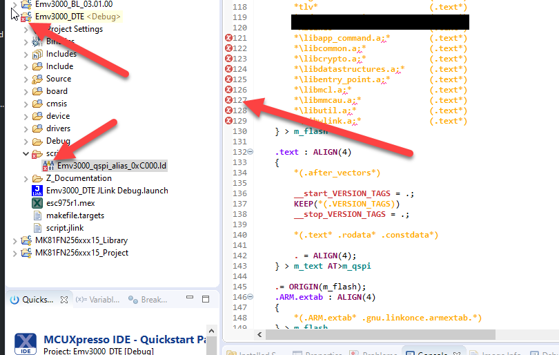

Starting from MCUXpresso 11.0 a feature is added to do syntax highlighting in linker files and map files.
Although this feature is nice, it generates incorrect errors.
Example:
.flash : ALIGN(4)
      KEEP(*(.Timer));
      . = ALIGN(0x100);
      *board*                (.text* .rodata* .constdata*)
      *\libcommon.a:*   (.text*)                                 /* include all required object files from library libcommon.a */
} > m_flash
The syntax checker gives the following error at the colon in the line *\libcommon.a:*
      no viable alternative at input :
The build succeeds with correct output files but according to the IDE the project was not built. (Red indication on project and linker file)
The more annoying side effect is that the J-LINK debugger does not want to start.
Resulting messagebox is:
      MCUXpresso IDE: Error
      Unable to perfor operation: project build failed!
SO, question is..
How can we disable this syntax checking.
Luc

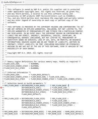

Emiel1984
Difficult to believe that I did run into this same issue with the latest released mcuxpresso.
Seems it isn't solved 2 years later. Have to thank @ErichStyger it solved the issue for me.
Path in mcuxpresso:
mcuxpresso->Window->Preferences->General->Editors>File Associations-> 'FileType *.ld'  -> 'Text Editor' ->Default
After this I was still required to 'delete' the already created error in 'Problems' tab. But I was able to debug again.
I did also find it strange that if use a linker file located in an SDK, the issue will not appear at all.
The issue only appeared after copying it into my own project.
@lpcxpresso_supp  maybe it would be nice the the default editor for NXP tools in general is an text editor until the moment it would not trigger these false errors that block you from debugging. This issue created a lot of weird\amazed faces in my office..

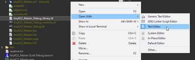

ErichStyger
Specialist I
To disable the syntax checking, I have found following simple solution:
Change the editor to be used with Open with:
This will use the normal text editor for it.
Other *.ld files are not affected.
To change it globaly, go to workspace preferences and change the default for all *.ld files:
I hope this helps,
Erich
