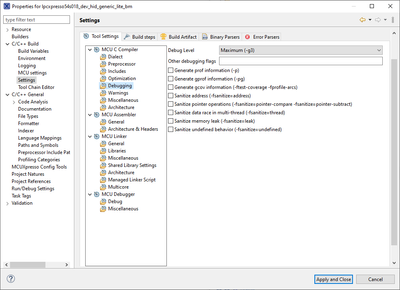

Do I need to go to properties and change some setting?

Create a new project or use the Quickstart Panel => Quick Settings shortcut. See sections 12.1 and 16.4 from User Guide.

I think the behavior is caused by an incorrect (or rather not according to your expectations) project configuration. If your work is based on an SDK example, you probably set "SDK Debug Console" to "UART" during the project creation. Thus, no "printf" available.
My assumption is also based on the usage of Redlib nohost-nf variant.

That's the problem, I do have SDK_DEBBUGCONSOLE selected,
Do I need to create a new project or can I some how select "DEBUGCONSOLE_REDIRECT_TO_TOOLCHAIN"?
7,896 Views
lpcxpresso_supp
