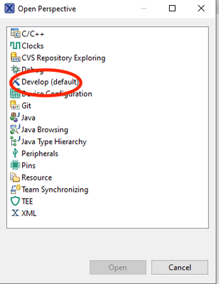

At this point I'm unforunately quite lost. I've tried to navigate my way around the project. I hit Config Tools -> Pins and got to a state I can't return from. Trying to select my project from the drop-down menu does nothing and there is a drop-down with one option ("MCU is not selected").

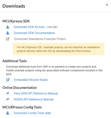

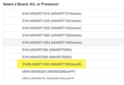

Based on the information that you provided it seems that you have the EVKB-RT1050 evaluation board. But the SDK  that you downloaded is for the EVK-RT1050 board, this SDK is for the first revision of the EVK which you don't have. The proper SDK to download is the following:
Once you download the SDK you will also need to download the SDK documentation. Within the documentation, you will find a file named Getting Started with MCUXpresso SDK for EVKB-IMXRT1050.pdf. This file will help you to get started with the SDK.
Regarding the application note that you mentioned, we provide an example project for this app note as well. You can download it from the following link

Sounds like you need to get back to the Develop perspective.
1. Press the Open Perspective button on the toolbar (towards the top right of the window)
2. Select the Develop perspective and press Open
