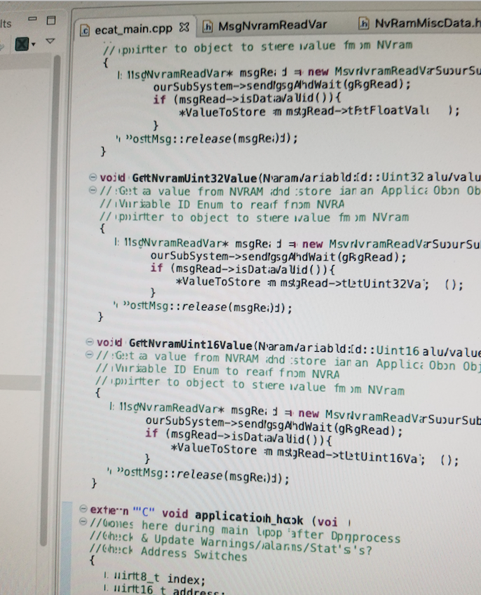

When I horizontal scroll the error window or text window to characters that are off the window, when the characters come into view they are garbled.  Improper rendering of text.   Scrolling up or down a line redraws it properly, but it is ANNOYING.
Using a MAC.
I'd include a screenshot, but as soon as I launch the screenshot utility, the text recovers.
Sounds like some Mac update/refresh issue

I understand that you find this annoying - I've occasionally seen the issue myself too (I primarily run the IDE on Mac), so I do sympathise.
But as I previously tried to explain, this editor UI update issue is a problem in the Mac version of the underlying Eclipse framework that MCUXpresso IDE is built on top of. It will therefore affect any Eclipse based product from any vendor that uses the affected Eclipse version(s) --> it is not an MCUXpresso IDE specific issue.
Once we migrate to a newer Eclipse version, this should resolve the issue. And until then the workaround when it occurs is at least fairly straightforward. I really hope that this doesn't put you off using MCUXpresso IDE, or NXP MCUs.

It sucks the “work-Around” is to have to cursor up or down every minute or two.
It affects the Error Window too, such that you have to put the cursor on the line and move to the right with arrow keys in order to get an error with no garbled characters.

This appears to be a generic Mac-specific Eclipse problem: 548491 – [regression][mac] Cheese in java editor
For the moment, as you state, you will need to force a redraw (e.g. by scrolling) to workaround. But it should be resolved when a new release of MCUXpresso IDE migrates to using a newer Eclipse release later in the year.

velias
Here you go attached is a screen shot, when I scrolled to the right. It “corrects” when I move up or down a line:
