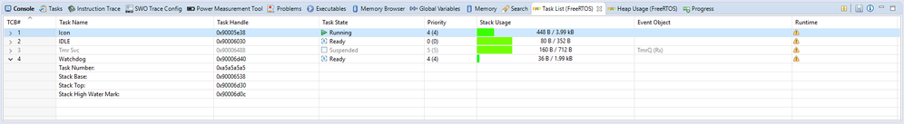

If I create a task with 2048 byte stack (call the xTaskCreate() function with parameter usStackDepth = 512) at the exit of the xTaskCreate() function I can see the correct stack usage:

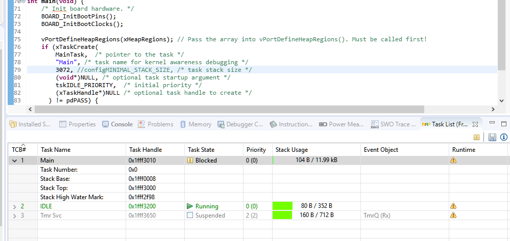

If I create the same task with a bigger stack, e.g. 12288 byte, (call the xTaskCreate() function with parameter usStackDepth = 3072) at the exit of the xTaskCreate() function I see that the task has overflowed the stack:
It seems that it is related to the usStackDepth parameter: below the 2100 value it works and above it don't.

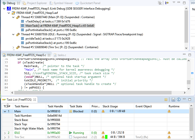

It seems the same problem described on this thread: FreeRTOS task viewer shows overflow.
Is it a problem related to the task aware viewer or to FreeRTOS itself?

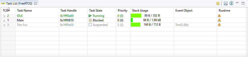

I don't have that project shown above, but I had a chance to try out the new plugin and it shows the stack for a 512 unit task in a proper way:

I tried with 3072 units, and that works in that updated version too for me:
So this means to me that this one should be really fixed in that new (coming) version.

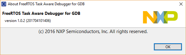

I'm using the FreeRTOS plugin version 1.0.2
Is it the same you are using?
Many thanks
Biafra
4,990 Views
BlackNight
No, I'm using a beta version of what is supposed to go into that new release end of this month.

BlackNight
And here with
#define configRECORD_STACK_HIGH_ADDRESS         1
