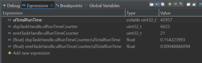

enricorocheti_
Hello @ErichStyger,
I'm experiencing a similar problem using the latest MCUXpresso IDE version (v11.10.0).
I'm using an RT1160 custom board and I'm able to correctly measure task ulRunTimeCounter and ulTotalRunTime variables:
However, in the IDE runtime stats viewer, I'm unable to visualize runtime percentages.
Am I missing something here? Do you know why the percentages are not being displayed?

AdrianOltean
I also confirm the issue. Unfortunately, "ulTotalRunTime" is incorrectly read in non-SMP context. But this affects only the actual percentage shown in the Runtime view. We'll make sure this'll get fixed in the next release.
12:59:27.833 ERROR: [VariableReader] -data-evaluate-expression ulTotalRunTime[0]
12:59:27.833 ERROR: [VariableReader] Error message from debugger back end:
12:59:27.833 ERROR: [VariableReader] cannot subscript something of type `unsigned int' java.lang.Exception: cannot subscript something of type `unsigned int'
12:59:27.833 ERROR: [TaskFactory] ulTotalRunTime not available
