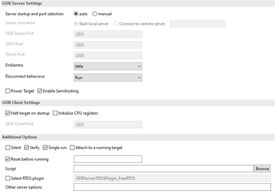

Hi everyone,
As our development has got bigger over time, our ability to debug it inside MCUXpresso / gdb has progressively worsened. We're now seeing a delay of around 30 seconds between hitting a breakpoint and the debugger returning control to us, which is... not exactly ideal.
After (many) experiments, we discovered that the problem disappears if we untick the "Select RTOS plugin" (in the launch configuration's JLink Debugger tab), so it seems to be to do with that.
Furthermore, there is no slowdown near the start of main(), but the responsiveness gets progressively worse the more tasks get launched (20 threads is typical for our devices). Hence it seems likely to us to be a slowdown issue (a) caused by the FreeRTOS plugin, and (b) to do with the number of active tasks.
Our FreeRTOS plugin seems to be configured correctly (e.g. uxTopUsedPriority and FreeRTOSDebugConfig both have valid addresses, etc), and there are no error messages visible in the JLinkServer console window, so everything seems to be working correctly. (Correctly, that is, apart from the 30+ second silent pause when you hit a breakpoint in normal running.)
Is this a known issue? Is there a workaround?
Thanks, Nick
PS: our modules are based on the i.MX RT1064

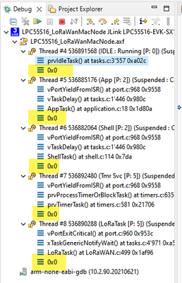

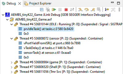

You have to distinguish between the GDB thread awareness (Debug view):
Clearly, the more tasks you have, the more data the debugger has to read from the target. With a J-Link this takes maybe around 1 second for 10 tasks. The target stops, the debugger needs to go through the list of tasks and then perform the stack back-trace.

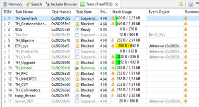

And there are the other views from NXP, like the task list:
They are even more intrusive, because they need to read a lot of more data and traverse extra data structures. So I recommend to use these views only if needed, put them into the background so they are not visible, or use the 'pause' button.

Just one thing: have you terminated the task stack frames with a zero value as shown below? Because this makes the stack crawl faster and terminates the search. Maybe it is just this?
Erich
8,483 Views
np
Hi Erich,
Ooh, that's interesting, I haven't seen that trick before!
How do you do that? Just set the link register = NULL at the start of a task, or is there a better way?
Thanks, Nick

ErichStyger
Specialist I
Hi Nick,
it is set with configTASK_RETURN_ADDRESS
Erich
8,461 Views
np
I've set the task return addresses to NULL as you suggested, but I'm still getting the same 30-second slowdown as before. So this is back to looking like a FreeRTOS J-Link GDBServer plugin issue.
