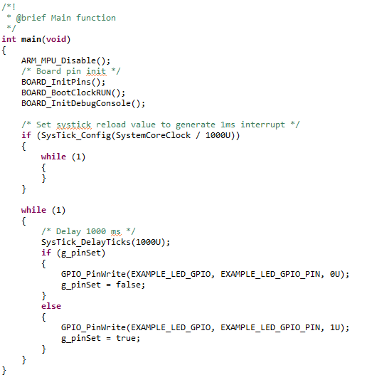

Here is my main code.

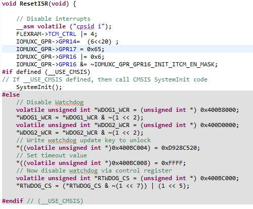

I add the register setting in the function "ResetISR".

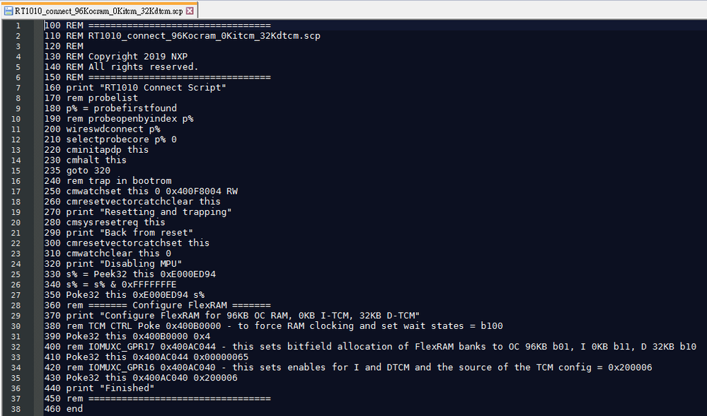

I use the following connect script.

Hi Calvin,
This is because your scp file disabled ITCM. But the IDE want to download flash driver(.cfx)  to ITCM. Without flash driver running in ITCM, IDE can't download application code. The attachment is my scp file. Please take a try.
Jing
