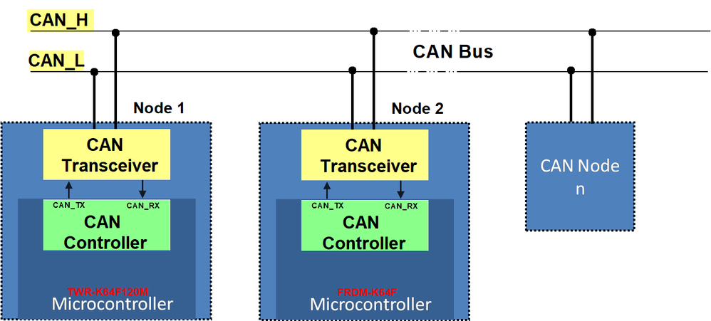

 Further when I tried Internal loop-back program of flexCAN example in FRDM k64F,it was successful but when I run the interrupt mode method where I flashed flexCAN code in two FRDM k64F boards. One node being "a" and other being "b" as per the example , it was not successful.
    Connection wise I connected both TX together, Rx together and a common ground. I did not use CAN transreceiver with either of the boards. Am i missing something here?
   Is it because I do not have an external CAN transreceiver here?

Hi Niranjan,
If you want to communicate via CAN to each other (TWR-K64F120M <--> FRDM-K64F), external CAN transceiver is needed.
There is a CAN transceiver(TJA1050T) on TWR-SER board which can connect with TWR-K64F120M.
But you still need another CAN transceiver for FRDM-K64F.

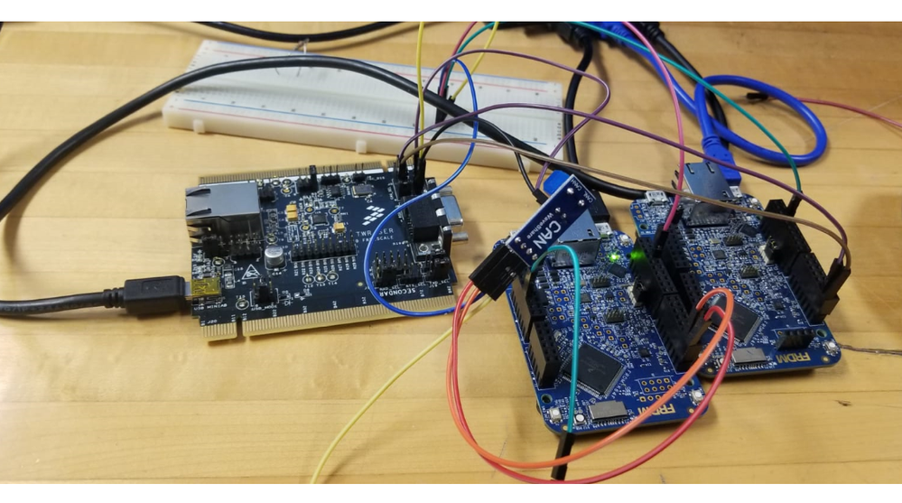

1.I connected on frdm k64F board to TWR-SER CAN transreceiver board(TX and RX of K64F(PTB18,PTB19) to Tx and RX of TWR-SER board as mentioned above)
2.I connected another FRDM k64F board to waveshare SN65HVD230 CAN transreceiver. (TX and RX of K64F(PTB18,PTB19) to Tx and RX of SN65HVD230 CAN)
Finally CAN_H and CAN_L of two transreceivers are connected together.
I downloaded twrk64f120_flexcan_interrupt_transfer demo application from the SDK_2.5.0_TWR-K64F120M\boards\twrk64f120m\driver_examples\flexcan.
(thread reference for SDK source : CAN communication in Rapid IoT board )
As per the documentation in that demo, it should work when there are two nodes a and b. I also followed it, one board being node a and other being node b.
But
while (!txComplete)
keeps on going for infinite loop and I cannot see any output.
Can you please verify if the demo is working fine? I am not sure why this is happening.
I have attached the circuit pic below:
Please note I tried connecting all grounds together and adding 120 ohm as well.
Nothing helped me.
Any help would be appreciated.

   Pls ignore my previous post. I got it working. The issue was with Transreceivers. Thank you for your inputs.
