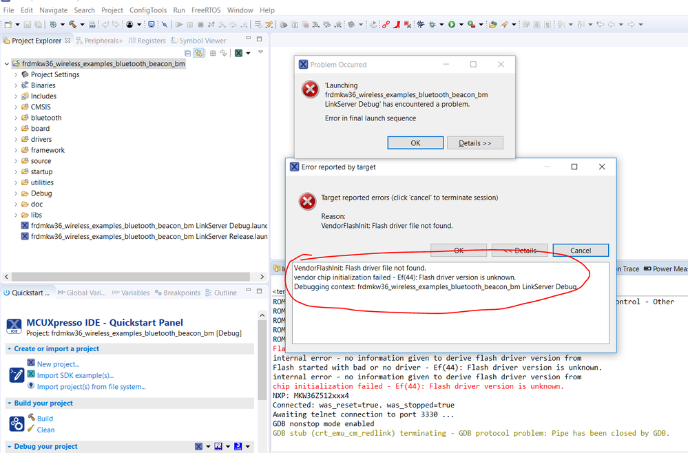

I am debug FRDM-KW36 board with MCUXpresso IDE v10.2.1 [Build 795] [2018-07-25], but it shows Flash driver file not found error when download the app with on-board cmsis-dap, the error information is as below, any advice?thanks.

Hello Const, I hope you're doing well,
Could you please try downloading the MCUXpresso installer directly from the download page? Some important bugs were fixed in the 10.3.1 version.

ConstYu
The problem is solved after un-install the old version and then re-install the V10.3 version

ConstYu
Hi Sebastian,
Thanks for your advice, i tried to update the version by click help->check for update, but it show no any update.
does it mean i must uninstall the version V10.2, then install V10.3?
from the previous error information, looks there is no flashloader support. not sure whether they are related.

Sebastian_Del_Rio
