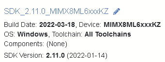

I am using MCUXpresso v11.5.0 for Windows which is latest. Also, I just used SDK-Builder to generate and download this:

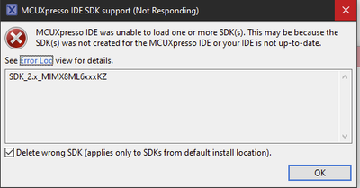

but when I try to install this in MCUXpresso I get the following error:
This happens whether I use drag and drop or the install SDK dialog. Help?
BTW clicking on the "Error Log" link crashes the IDE.
Chris

Hi @ChrisN
MCUXpresso IDE doesn't support MIMX8, its supported devices are listed here
https://www.nxp.com/design/software/development-software/mcuxpresso-software-and-tools-/mcuxpresso-i...
Officially, it supports GCC ARM and IAR only. MCUXPresso IDE is not enabled.
