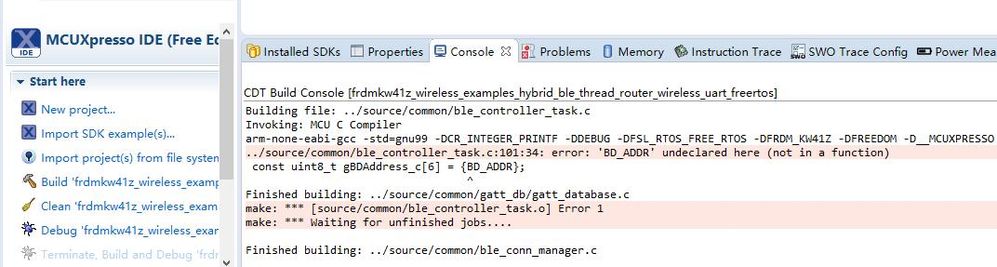

Hi, I am using MCUXpresso Integrated Development Environment (IDE) v10.0.2(free edition). I have imported several wireless examples from SDK_2.2_FRDM-KW41Z, following the guidance of  FRDM-KW41Z website. But the same error occured when I built them in MCUXpresso IDE v10.0.2, as shown in the screenshot below,('BD_ADDR' undeclared here)
However, they are successfully built in MCUXpresso IDE v10.0.0 if I import them from SDK again, but it fails if I just open the projects which have been imported and created by IDE v10.0.2.
So, what's wrong with the IDEv10.0.2? And how to solve the problem?

The exact error is as follows:
../source/common/ble_controller_task.c:101:34: error: 'BD_ADDR' undeclared here (not in a function)
 const uint8_t gBDAddress_c[6] = {BD_ADDR};
make: *** [source/common/ble_controller_task.o] Error 1
make: *** Waiting for unfinished jobs....
So this is the same error as mentioned above.
In both cases, so with only one and with several imported examples I receive the error. But I recognized that I can build the examples ble_relay_proxy and ble_shell without problems although they also utilize the function ble_controller_task.c in which the undeclared BD_ADDR can be found.
Lukas Krupp

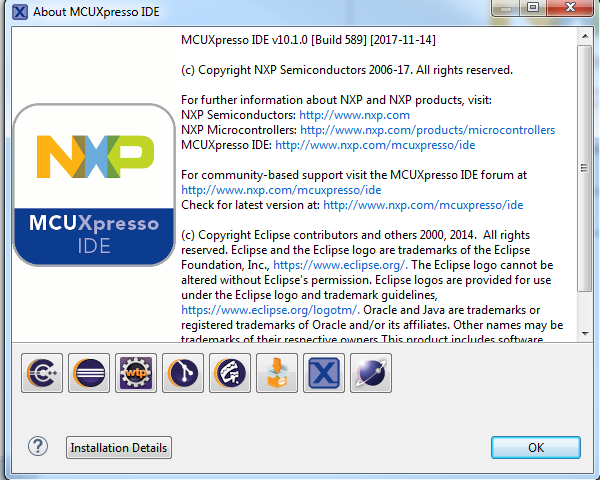

today I encountered the same problem. I tried to solve it via the explanation above but the error remains.
I have the latest MCUXPressoIDE 10.1.0 Build 589 and the SDK 2.2.0 from 2017-08-18.
Is there any chance to solve this problem in another way?

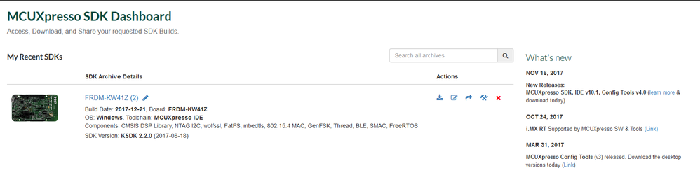

When did you download your SDK? I believe that there was a new build of the KW41 SDK made available shortly before MCUXpresso IDE v10.0.2 was released that fixed an SDK issue  (exposed by changes in MCUXpresso IDE v10.0.2).
Thus a good starting point would be to log in to http://mcuxpresso.nxp.com/ and see if you have an SDK update available.

To explore this problem, I have downloaded the KW41z SDK  from the SDK builder and imported the example 'frdmkw41z_wireless_examples_hybrid_ble_thread_router_wireless_uart_freertos'. I see this build without error in MCUXpresso IDE 10.0.2 build 411.
Now there have been changes made to this SDK, so please can I ask you to do the following to ensure you are using the latest SDK for this part.
1 - from within MCUXpresso IDE, select the installed SDK tab. Right click on the SDK_2x_FRDM-KW41z entry and select Delete SDK
2 - go to the the SDK builder page at:
Welcome to MCUXpresso | MCUXpresso Config Tools
From here go to Manage -> Manage Existing Configurations and ensure that there is no KW41 SDK present in your list of configurations. If one is present, please delete the entry.
Then request a new SDK build of the KW41 SDK and install that into MCUXpresso IDE 10.0.2 and import and build the above example. I believe you will see this build without error.
