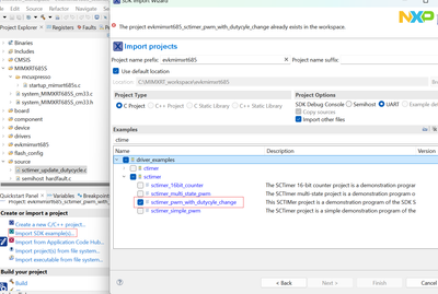

I firstly use RT685 EVK board. I imported the SDK example code, and the code is built ok. I debug as SEGGER J-Link probes, and program flash is no problem. But the code hanged in as below:
Break at address "0x1c04a" with no debug information available, or outside of program code.
0001c04a: b.n 0x1c04a
I don't know why that? I suspend this in debug, the stack usage is showed as Overflow. Now I cannot take the next step. Who can help me? Thank very much.

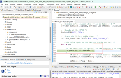

    为了更好的给您提供专业的服务,我借用之前Case的一个例程为您解答。
sctimer_pwm_with_dutycyle_change 版本运行正常。
硬件:MIMXRT685-EVK
SDK版本:SDK_2_16_000_EVK-MIMXRT685.zip
IDE版本:MCUXpresso IDE v11.10.0
同时我也咨询 RT685系列产品专家,建议您检查以下几点:

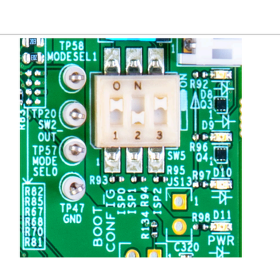

1:确认您的板子是否是MIMXRT685-EVK ,以及硬件Boot  Mode模式以及其他设置是否正确。

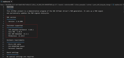

2:在SDK安装包中找到readme.md ,路径如下所示:
MIMXRT685\SDK_2_16_000_EVK-MIMXRT685.zip\boards\evkmimxrt685\driver_examples\sctimer\pwm_with_dutycyle_change
里面描述了硬件,SDK版本、MCUXPresso版本号等,需要对应匹配。
3:确认MCUXPresso导入工程是否正确。
