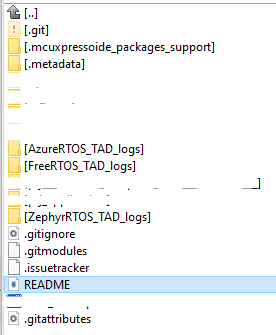

I'm using MCUXpresso for LPC55xx ("baremetal" application)
MCUXpresso creates the following folders on my hard disk even though I am not using an operating system:
- ZephyrRTOS_TAD_logs
- FreeRTOS_TAD_logs
- AzureRTOS_TAD_logs
How can I disable the "auto creation" of these folders/files?

my MCU-version:   MCUXpresso IDE v11.6.0 [Build 8187] [2022-07-13]
The folders are as @ErichStyger stated (located in the workspace folder):
Best regards, Andreas

Currently there is no switch exposed in the UI for controlling this. Logs associated with active debug session are saved in the folders you noticed, once the debug session is ended. Note that only the most recent 4 logs (if I remember correctly) are kept.
Are those folders interfering in any way with your work/projects? Maybe we can plan adding a preference that controls the logging mechanism for each RTOS plugin.

I'm sorry but there's no way to avoid those files/folders. I logged an internal ticket to track your request. Hopefully, it'll be addressed in the next release.

I would also like to make these TAD logs optional. It is a waste of SSD write endurance in my case.

Hi @robertmorrison ,
I wrote in https://mcuoneclipse.com/2023/01/25/nxp-mcuxpresso-ide-11-7-0/ about how you can make the TAD logs optional or disabled.

   Excellent! I tried this and it works--and in 11.8 they have added a general option to turn off creation of the logging console as well as the logging messages. Now the build console is at the top of the list, the one I most often need to see. This post also has a whole lot of other stuff I found very useful.
