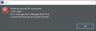

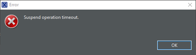

First, thank you so much for your patience and for reading my post. It is long. I've tried to be both thorough and concise.
Summary:
Debugging is very unstable using Segger J-Link Plus with MCUxpresso 11.4.1 and MCUxpresso 11.5.0. Using the debugger through MCUxpresso appears to attach and download but I cannot debug. The exact behavior varies. I’ve tried everything and I have workarounds that intermittently work. Details including debugger console output are below.
Version 11.2.1 was stable for me but my project requires upgrading to 11.4.1.
I am using a mature custom board using an imxrt1060. The debugging interface is SWD. I’ve been able to reproduce several of these issues on an evk with sdk examples. I have made a support ticket and one of my issues (unable to “Restart”) was able to be reproduced but I have many more.
SDK version is 2.8.6. I also tried 2.11 with MCUx 11.5.0
Details:
Behavior observed:
  • Debug RAM config
    • First breakpoint appears to be the hardfault handler. Pressing play halts at the same line. console output below. Look for WARNING: Failed to read memory @ address 0x10D7263A
    • No start breakpoint hit. Pausing shows the PC is in bootrom (0x200000 range). I know the boot mode is set correctly and can prove it if you aren't satisfied. Using serial download mode to erase/program does not fix it.
    • Gets to main but when I step even once it doesn't hit the next line/instruction it just appears to be running. When I press pause it has been in bootrom or flash and I want to say even RAM instructions but I cannot debug.
    • Works after multiple attempts - hit debug and PC is in bootrom, stop and re-debug and I get the hardfault issue, trying a third time gets to main and I can debug
    • Does not work with the "Reset before running" box checked in the “J-Link Debugger” tab of the debug configuration. I believe this option is supposed to be ignored for RAM configurations.
    • Runs to main. Press run and pause work debugging appears normal for a very brief time, then pausing moments later shows the PC in bootrom
  • Debug Flash config
    • Goes to main. Stepping does not hit the next line. Hitting pause shows the PC at flash memory locations (call stack will show 0x60000000 addresses) but no link to code. If I make an "attach only" configuration I can debug the application normally but only after power cycling the board
    • Latest behavior is that I cannot attach to it and after restarting / power cycling the board the program does not print anything to the console.
  • Debug RAM or Flash
    • Debugger "halts" at 0xdeadbeee. Pressing run goes to main and then I can debug normally (this also happens in MCUxpresso 11.2.1)
    • Using my work arounds and finally being able to debug - cannot restart a debug session with the Restart button. Hitting restart appears to do nothing only that the program is "running" because the pause and stop buttons are active and the play button is grey. Hitting pause usually shows the PC at the same location repeatedly.

CraigCo
I made a small project from my flash project that reproduces the flash debugging issue on the EVK. It is attached along with the debug console.
When I hit main and step once, I loose the debug session. When I hit pause it is at a flash address as described previously. This can be seen in the log at this line:
Halting target CPU...
...Target halted (PC = 0x610FA140)
I then restart and am able to single step correctly.

CraigCo
To be honest, I am a little lost and confusing about your issues, I even don't very clear about your detailed situation now.
So am I @kerryzhou. So am I. I'm sorry for the confusion. Sometimes everything is working for brief moments and then suddenly it is not. I think I have more than one issue and so it is hard to keep things straight. This morning I am able to reliably reproduce one of my issues which is the flash issue I was describing. I have a video file attached as requested. This was also what the previous project I attached was doing in my last reply.
Project: evkmimxrt1060_hello_world
SDK: 2.11
MCUxpresso: 11.5.0
J-Link Plus v11.00
This issue does not exist when I use the CMSIS-DAP on the evk board.
Issue: runs to main, single step appears to run, not to go to the next line. Pausing shows the PC at some random flash location with no link to code. Attempting to single step produces this error:
The Restart debug button works as it goes back to main. Now debugging works normally.
If I don't use the restart button and just try to terminate and debug the same issue persists. Restarting is required to debug successfully in this case.
If I rebuild with cache disabled the issue is the same.
If I link to RAM it debugs normally in this case.
If I erase flash then re-debug the debugger shows 0xdeadbeee. I press run and it goes to main. Debugging works normally after this (video attached). Re-debugging again reproduces the same flash issue as before, have to restart to debug.

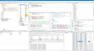

kerryzhou
Hi @CraigCo ,
   The video tested code evkmimxrt1060_hello_world is from the SDK code, right?
   Our IDE expert already tested your customer code, this is the related information:
We also did some further testing and observed that in the client’s application, there seems to be a problem inside the startup code at the .bss initialization:
-at the first debug attempt with break at ResetISR, we noticed that in bss_init the value for “start” and “len” are wrong.
-after restarting the debug session(using restart button) everything looks fine
Looks like a problem after initial application is downloaded in flash(J-Link or project configuration problem). Since the projects from SDK are working fine, please advise the client to try to make a diff between his application and an SDK one (like iled_blinky).
To the SDK code, our expert tested for several times on the MIMXRT1060-EVK board and the external JLINK plus, didn't meet the issues.
So, can you do the MIMXRT1060-EVK board flash mass erase at first, then test the SDK code, whether still like the .mp4 issues? Just let it reproduce with the NXP EVK board and SDK code, then it will be useful to our internal side.
Please help to confirm your attached .mp4 already the NXP EVK+SDK demo+external JLINK.
Kerry

kerryzhou
Hi @CraigCo ,
   I get the new information from our expert:
since the debug session works for the “restart scenario”, there seems to be a problem related to initialization / reset / timings because the problem occurs when the debug session is terminated and restarted.
An idea would be to try to debug the startup code using “Instruction” stepping  and looking at data_init and bss_init.
Another idea would be to try with different SWD wire speeds.
Can you try these on your side with the EVK+SDK code, as now, no one from our side can reproduce the issues, seems your side is not stable, use slow SWD speed, check whether it has any difference or not?

Retried to debug later and it loaded to ResetISR. Pressed play, debugger appeared unresponsive then got the following message:
And then noticed the debugger was at my breakpoint at SystemInit in ResetISR. Tried to step and debugger was unresponsive and attempting to "pause" did not work. Pressing terminate was slow to respond but eventually terminated the debug session. This was with the cache disabled (see below on how), using the sdk 2.11 jlinkscript on the evk.
