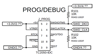

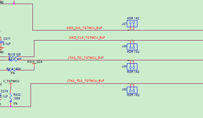

I am using a mature custom board using an imxrt1060. The debugging interface is SWD. I’ve been able to reproduce several of these issues on an evk with sdk examples. I have made a support ticket and one of my issues (unable to “Restart”) was able to be reproduced but I have many more.

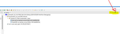

    • First breakpoint appears to be the hardfault handler. Pressing play halts at the same line. console output below. Look for WARNING: Failed to read memory @ address 0x10D7263A
    • No start breakpoint hit. Pausing shows the PC is in bootrom (0x200000 range). I know the boot mode is set correctly and can prove it if you aren't satisfied. Using serial download mode to erase/program does not fix it.
    • Gets to main but when I step even once it doesn't hit the next line/instruction it just appears to be running. When I press pause it has been in bootrom or flash and I want to say even RAM instructions but I cannot debug.
    • Works after multiple attempts - hit debug and PC is in bootrom, stop and re-debug and I get the hardfault issue, trying a third time gets to main and I can debug
    • Does not work with the "Reset before running" box checked in the “J-Link Debugger” tab of the debug configuration. I believe this option is supposed to be ignored for RAM configurations.
    • Runs to main. Press run and pause work debugging appears normal for a very brief time, then pausing moments later shows the PC in bootrom
  • Debug Flash config
    • Goes to main. Stepping does not hit the next line. Hitting pause shows the PC at flash memory locations (call stack will show 0x60000000 addresses) but no link to code. If I make an "attach only" configuration I can debug the application normally but only after power cycling the board
    • Latest behavior is that I cannot attach to it and after restarting / power cycling the board the program does not print anything to the console.
  • Debug RAM or Flash
    • Debugger "halts" at 0xdeadbeee. Pressing run goes to main and then I can debug normally (this also happens in MCUxpresso 11.2.1)
    • Using my work arounds and finally being able to debug - cannot restart a debug session with the Restart button. Hitting restart appears to do nothing only that the program is "running" because the pause and stop buttons are active and the play button is grey. Hitting pause usually shows the PC at the same location repeatedly.

CraigCo
I made a small project from my flash project that reproduces the flash debugging issue on the EVK. It is attached along with the debug console.
When I hit main and step once, I loose the debug session. When I hit pause it is at a flash address as described previously. This can be seen in the log at this line:
Halting target CPU...
...Target halted (PC = 0x610FA140)
I then restart and am able to single step correctly.

CraigCo
To be honest, I am a little lost and confusing about your issues, I even don't very clear about your detailed situation now.
So am I @kerryzhou. So am I. I'm sorry for the confusion. Sometimes everything is working for brief moments and then suddenly it is not. I think I have more than one issue and so it is hard to keep things straight. This morning I am able to reliably reproduce one of my issues which is the flash issue I was describing. I have a video file attached as requested. This was also what the previous project I attached was doing in my last reply.
Project: evkmimxrt1060_hello_world
SDK: 2.11
MCUxpresso: 11.5.0
J-Link Plus v11.00
This issue does not exist when I use the CMSIS-DAP on the evk board.
Issue: runs to main, single step appears to run, not to go to the next line. Pausing shows the PC at some random flash location with no link to code. Attempting to single step produces this error:
The Restart debug button works as it goes back to main. Now debugging works normally.
If I don't use the restart button and just try to terminate and debug the same issue persists. Restarting is required to debug successfully in this case.
If I rebuild with cache disabled the issue is the same.
If I link to RAM it debugs normally in this case.
If I erase flash then re-debug the debugger shows 0xdeadbeee. I press run and it goes to main. Debugging works normally after this (video attached). Re-debugging again reproduces the same flash issue as before, have to restart to debug.

kerryzhou
Hi @CraigCo ,
    Thanks for your detail information, and effort.
   I already contact with our IDE expert now, and some colleague who can test MIMXRT1060-EVK with external Segger JLINK plus.
   Now, to keep the same platform and code, could you please use the NXP MIMXRT1060-EVK board test with external Segger JLINK again?
  MCUXpresso 11.5.0
  SDK_2_11_1_EVK-MIMXRT1060
  Import hello_world project and led_blinky project. Test hello_world at first, as the led_blinky led connect to the JTAG_TDI, which may have influence.
  1. Board settings: remove on board jumper: J47-J50.
  2. MIMXRT1060-EVK board do the mass erase at first.
    You can enter the serial download mode, then use the MCUBootUtility tool to erase it.
Just make sure the external memory is clean.

  It's really good news, as previously, I misunderstand you, both the EVK and the custom board even can't work with hello_world with external Segger JLINK.
  Could you please also help to test this code:  sdk led_blinky, whether it works? As this led pin is the JTAG_TDI, it may influence the external JLINK. But my colleague also can make it work. Just confirm it on your side with IDE 11.5.0.
  Please also help to check your own project, do you have control the JTAG related pins?
  Can you reproduce the issues on the MIMXRT1060-EVK +external Segger JLINK with your own project in MCUXpresso 11.5.0?

For my board I only have the SWD signals connected:
"both the EVK and the custom board even can't work with hello_world with external Segger JLINK."
Regarding your comments, you understood me correctly before. That was true yesterday. I'm going to try to give you a picture of what this issue has been like because whatever is causing this issue feels very random. Something like the SDRAM setup or caching does feel like it is on the right track.

I can still debug on the evk. In fact this afternoon I can now debug normally hello_world and also iled_blinky on the evk. I can no longer debug either successfully on my board. This afternoon on my board I only get bootrom, it never loads to main. It is not in serial download mode. I do not have my jumpers on for this and MCUBootUtility does not find it because it is not in serial download mode. But still when I debug hello_world, which was working yesterday and this morning, this afternoon I get no load to main and when I pause the PC is always in bootrom. This was all with the flash configuration. I was able to link hello_world to ram and was able to debug normally first try no issues and restart even works. This may be different when I try tomorrow.
I diff'd the jlinkscripts from the new SDK vs the one I have been using and there are a lot of differences actually. I tried my old script with a new project on the evk and got some issues. These issues may shed more light on what has been happening. They appear to be fixed by using the 2.11 jlinkscript, at least this afternoon that is what happened. The debug view shows the PC at address 0xdeadbeee. pressing run did not go to main and the application appeared to just be running (common issue I've seen). Then I paused and it stopped at a line of code. Stepping worked. Running and pausing worked. Terminating and debugging again did not load to main, pressing pause did not appear to respond. Pressing terminate did not respond. I looked in the task manager and expanded MCUXpresso's task and there were 2 sub-tasks named arm-none-eabi-gdb.exe. I clicked "End Task" for both of these. The debugging in MCUxpresso then closed and I was able to retry to debug again. This time it ran to main and I was able to step through lines no problem, use breakpoints. HOWEVER! Then I tried to use the Restart button and it did not work. Pausing no longer worked. Terminating no longer worked.
Retried to debug later and it loaded to ResetISR. Pressed play, debugger appeared unresponsive then got the following message:
And then noticed the debugger was at my breakpoint at SystemInit in ResetISR. Tried to step and debugger was unresponsive and attempting to "pause" did not work. Pressing terminate was slow to respond but eventually terminated the debug session. This was with the cache disabled (see below on how), using the sdk 2.11 jlinkscript on the evk.
