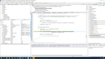

When breakpoints is stopped and there is lot of variables (like local variables for debugging observation), debugger stops and we need to rerun debugging. Debugger basically exits.
This can happen also if we expand struct having lot of elements. Number of variables to reproduce this don't need to be particularity high. (10 should work, but take 20 to be sure).
I am using lpcexpresso54628 and up to date mcuexpresso ide on Linux (debian 11).
I am debugging with cmsis debuger LpcLink2 and I got same issue when I tested this with debug probe firmware from Segger on same LpcLink2 probe.

I have recorded video that show what happens.
https://instrumentationtechnologies-my.sharepoint.com/:v:/g/personal/luka_rahne_i-tech_si/EVj9y-8NQ1...
You can see here, that I made demo app project from dev_composite_cdc_vcom_cdc_vcom_freertos
I than put breakpoint on virtual_com.c in line 362 .
I then open virtual com port and press key that triggers breakpoint.
When I expand vComInstance variable in debug view, debugger stops.
This can be seen at  3:00 in video.
At the end of video 4:15 you can see installed versions (should be up to date) and later available ram and disk of Pc.
In video I made project on top of lpcexpresso 54608 where I should do on Lpc54628 as this is system i am running. I did that offline and result is same.
Debugger I am running is from devboard (onboard debugger)

I just tested this with my MCUXpresso IDE 11.4.0, there is no issue
I suggest you test this demo with under a NEW workspace. see how it works.
If problem persists, reinstall your IDE.

I reproduced your issue with Ubuntu 20.04 +MCUXpresso IDE 11.4.1.
I will escalate it to IDE development team.
Will keep you posted.
