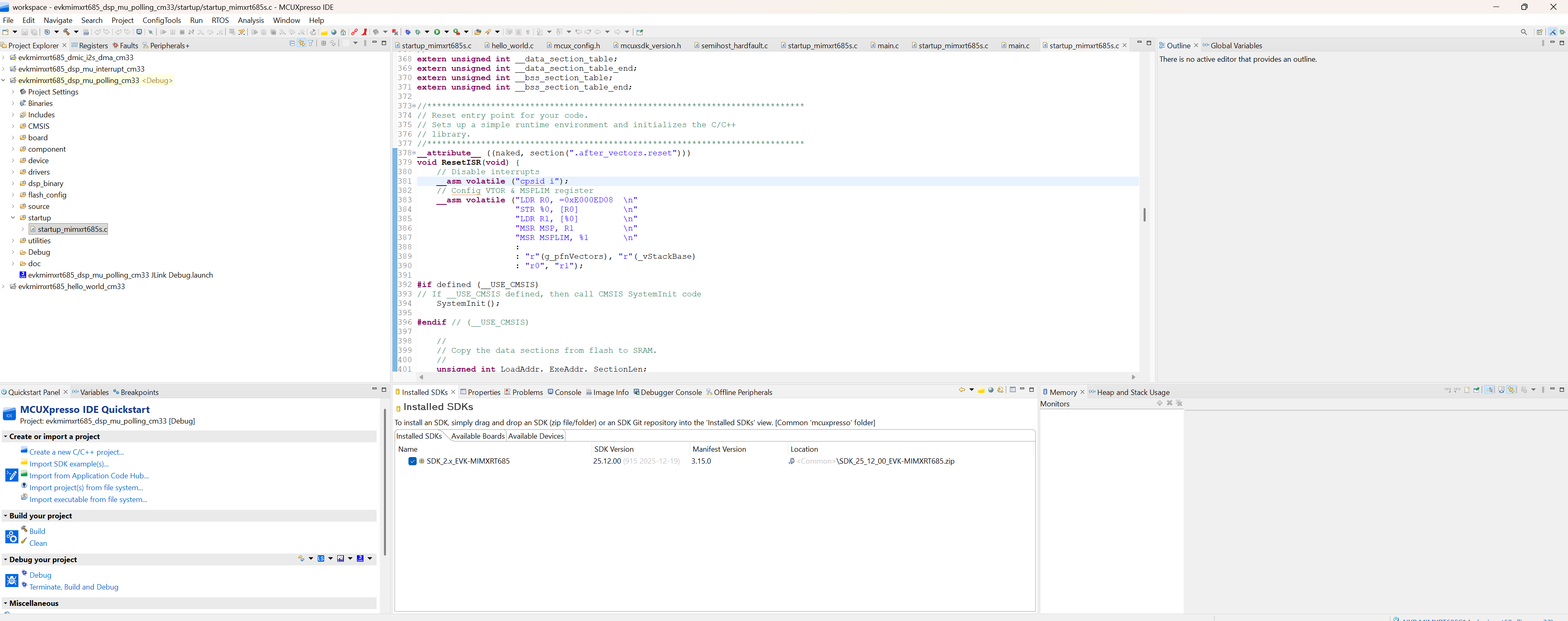

Hello Carlos, Posting the screenshot>
It happens on all the examples including hello world. It always stops at the first line of the "void ResetISR(void) function i.e. at the line __asm volatile ("cpsid i") (line No 381) in the startup_mimxrt685s.c file in the startup directory. It never get to the main() to start the run.  I am trying to run the evkmimxrt685_dsp_mu_polling_cm33. This example works fine in the 25.03 version. All versions after than (06,09,12) have this problem. Is there some change I should make in the IDE for SDK versions after 24.03 ?.   Thanks  bobvr

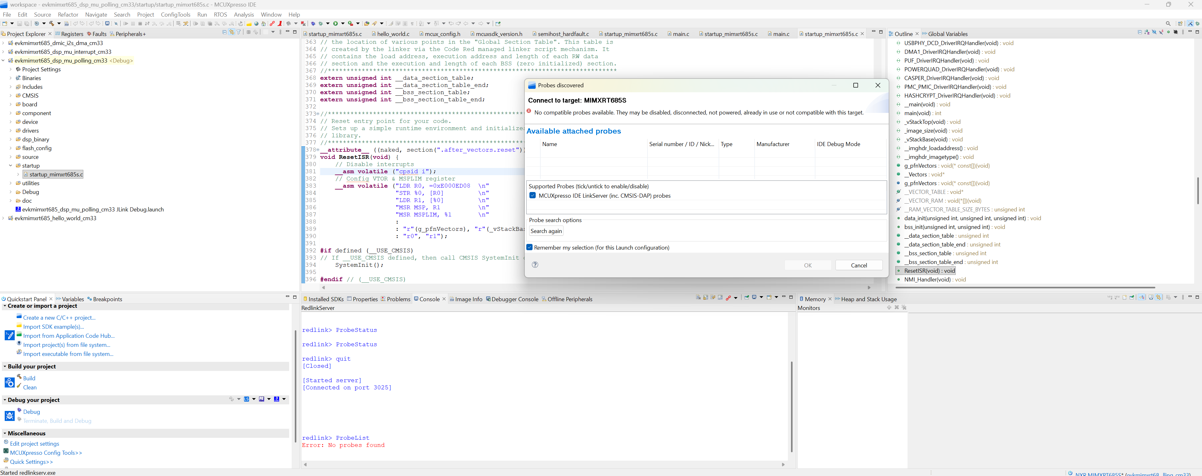

Carlos,  I tried to do a mass erase with the link server but got an error message - screenshot attached.  Thanks

Hello Carlos,  I deleted the Flash using the Segger J-Link Probes (not the link server probes as that firmware was overwritten by the Segger firmware).  I understand I must use the Segger probes to debug both the ARM core and HiFi4 DSP.  I also updated the Segger firmware to the latest version 8.98.  I deleted the debug launch file,  deleted the workspace to generate a new one on bootup and also power cycled the board.  Still the same problem.  It says a debug session is running but I'm not able to debug.  As i said this happens with all versions after 03 (06, 09 and 12).  It stops at the startup_mimxrt685s.c file as before.    In the debugger console I do see a warning  message but this is probably harmless.  "warning: could not convert 'main' from the host encoding (CP1252) to UTF-32.
This normally should not happen, please file a bug report.
monitor exec SetRestartOnClose=1
Please advise next steps. Thanks bobvr.
