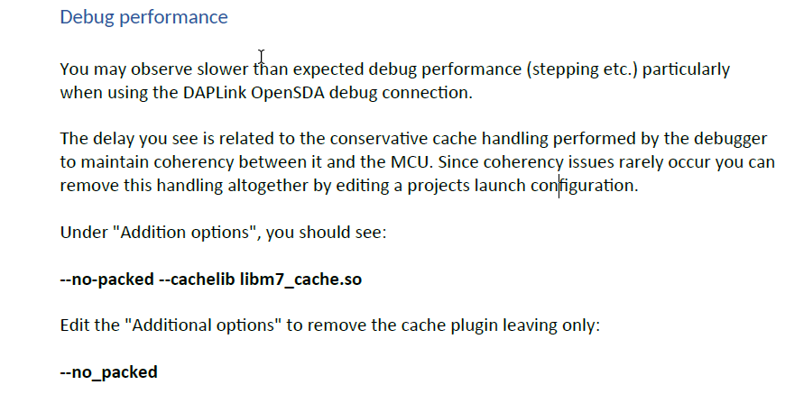

Hello Carsten Kanstrup,
Refer to your questions , I will give you a general reply:
1) Yes, due to the conservative cache handling, the debug is slower than expected, you can remove
this handing refer to below (about detail please refer to Overview of using the MIMXRT1050-EVK with MCUXpresso IDE  ),
You can also use external debugger J-link , it will faster than on board debugger.

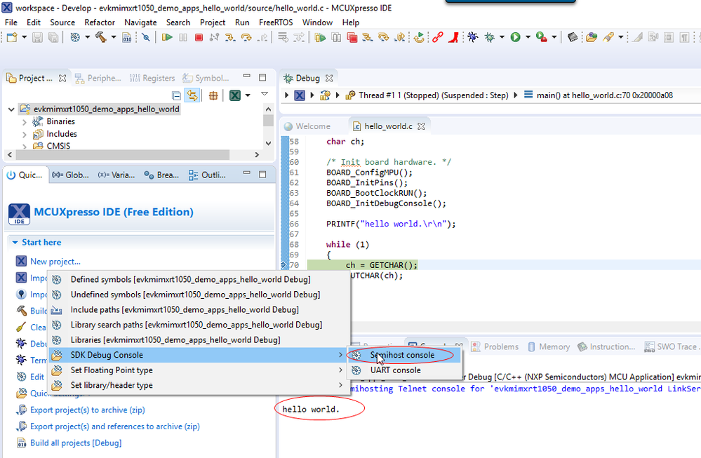

What about the error when you click resume ? Please pay attention that , when run the demo "ecompass",
after shows "Press any key to start calibrating..." on consle , we need press any key, then click "Suspend" button,
or it will show some error message.
3) "We never managed to get it to work again" ,-> could you please take a screenshot show how it can't work ?
Can't download  or debug or something else ?
" but the Console window did not show anything"->Please choose as below :

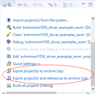

About save project, the name is "Export project " on MCUXpresso IDE:
Hope it helps

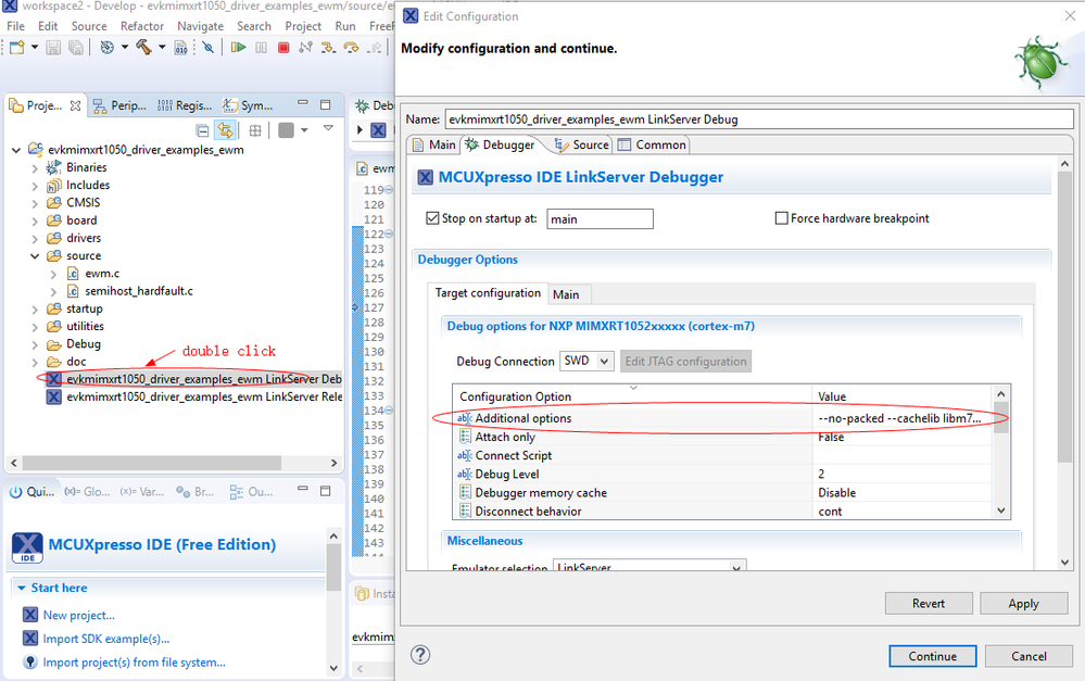

1) - I take a screenshot about the debug configuration place, please have a look :
And about this question  "Do you know if this cache switch-off disables the cache in the CPU, which would seriously affect the performance, or does it only affect the circuit while you are debugging?", I will double check with MCUXpresso Expert team .

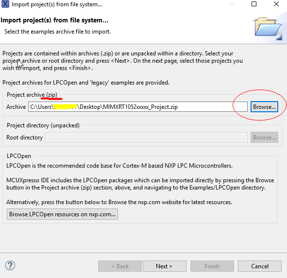

About export a .zip file , we needn't unzip it , when you want to open it on MCUXPresso IDE, just do as the below steps :
Hope it helps
