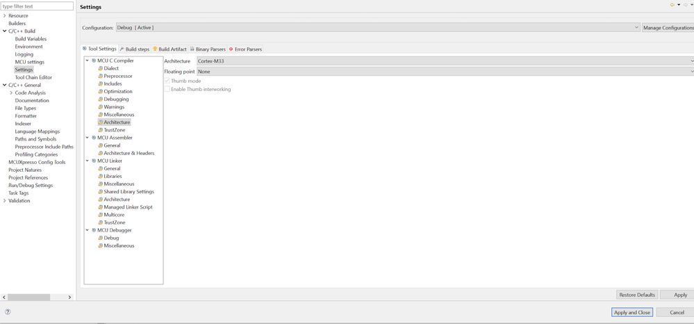

I'd like to compile my program with Arm mode. But when I go through the settings, the Thumb mode for cortex m33 is automatically greyed out and chosen.
Is there any way that I could compile without Thumb mode?
Edit: Or is any way to only have 32-bit Thumb mode not 16-bit and 32-bit mixed?
I'm using lpx55s69-EVK.
Thanks!
Claire

All Cortex-M processors, including M33, are Thumb only. They cannot execute ARM instructions. The are actually Thumb-2, which is an extension over Thumb-1, as used, for example, in ARM7TDMI.

Sorry it seems there is no method to disable it.
