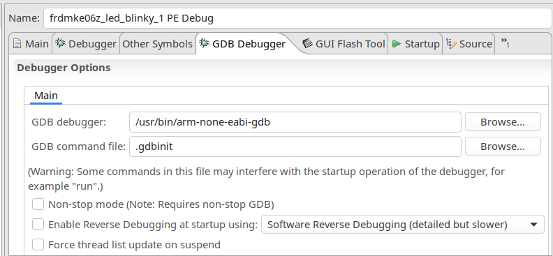

  • failed debug using default PEMicro launch setting
    P&E Semihosting Console. Connection closed by the GDB server.
    • debugger console reads "monitor setexceptioncatching 2033
    • monitor selectcore 0
    • Ignoring packet error, continuing...
  • modifying GDB settings with
    ${cross_prefix}gdb${cross_suffix}
    gets a little farther but still fails to initiate the breakpoint and step throug debug mode
I read through Connection closed by the GDB server and Eric's awesome mcuoneclipse tutorials and not having success! I am suspecting a serious GDB configuration issue I am missing here!

Hello Michael,
Could you try making a change to the "executable" option in you the "GDB Client Settings" section? The executable you will want is the "arm-non-eabi-gdb.exe". It should be located in your MCUXpresso folder with the following path /ide/tools/bin.
Let me know if this resolves any issues.
Steve

Thank you for the suggestion, I tried this:
changed it to path in /ide/tools/bin and that did not work either. See errors below:
Could not determine GDB version after sending: /home/michael/Downloads/mcuxpresso-ide/pkg/mcuxpresso-ide/usr/local/mcuxpresso-ide/ide/tools/bin/arm-none-eabi-gdb --version, response:

Hi Michael,
I believe you should be in the "Debugger" tab rather than the "GDB Debugger Tab" like how you had in your first screenshot. Revert the changes you made within this tab and refer to my first response and try this again.

michaeljwilson
Thank you for that note. I went back and changed it only in the debugger tab, the error is the same now.
Initially, this was the same error I got when I first installed the IDE. After installing arm-none-eabi-gdb manually in linux path /usr/bin/ then the GDB version was found. From the looks of this, there are two problems on using IDE on linux, 1) installing the IDE does not link the arm-none-eabi-gdb path properly and 2) the GDB configuration produces a "connection closed due to timeout" error.
