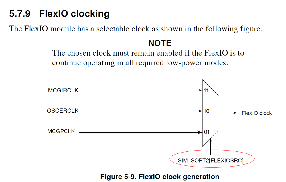

Hello! I am trying to configure the FlexIO as UART with baudrate less than 115200 in a FRDM-KL43Z, but I can´t do it.
I am using the SDK example called: flexio_uart_interrupt_transfer.c , for MCUXpresso IDE.
I was reading some posts that it is needed to decrease the Clock Frequency to make the divider less than 0xFF to use it in the TIMER_CMP.
As my clock frequency is 48MHz, and my baudrate less than 115200, the timer value is bigger than 0xFF; the code implemented uses this:
timerDiv = srcClock_Hz / userConfig->baudRate_Bps;
timerDiv = timerDiv / 2 - 1;
if (timerDiv > 0xFFU)
result = kStatus_InvalidArgument;
So, as timerDiv is bigger than 0xFF, it returns invalid argument.
How can I  configure the clocks and the flexio to work with baudrates lower than 115200 bps?
Best regards.
D.

Hello Diego Valerio,
The baud rate divider equal to (CMP[7:0] + 1) * 2, the maximum of CMP[7:0] is 0xFF,
so the if use 48MHZ source clock, the minimum baud rate is
srcClock_Hz/((CMP[7:0]+1)*2) = 48000000/( (0xff+1)*2) = 48000000/512 = 93750HZ.
If you want to low the baud rate ,  you can choose low flexio  source clock:
Hope it helps,
TIC
