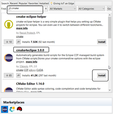

It will be interesting for us (as @danielholala already mentioned) if an example project from SDK is compiling ok on your environment.
We suspect you are using cmake4eclipse plugin which has a reported issue on eclipse community:
https://bugs.eclipse.org/bugs/show_bug.cgi?id=575903
Its fix will be integrated with a newer eclipse version in our next major release.

How can I see if I'm using cmake4eclipse plugin ?

the cmake4eclipse can you find on MCUXpress, in the menu help --> Eclipse marketplace, find cmake and you can find if have or not the cmake4eclipse

it seems I've not installed such plug-in.
what can we deduce from this?
6,260件の閲覧回数
CarlosGarabito
Well, We can deduce that the problem didn't come from cmake4eclipse plug-in, so, you can check if you can make, build and compile an example project with the new version of MCUXpresso IDE in an new workspace (you need make new folder were you can store the new project)
