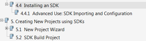

Hello Shaowei,
Please first install an SDK into MCUXpresso IDE.
The detail steps please refer to "MCUXpresso IDE User Guide"
4.4 Installing an SDK and 5. Creating New projects using SDKs .
If still have error , please show your steps .
Hope it helps
