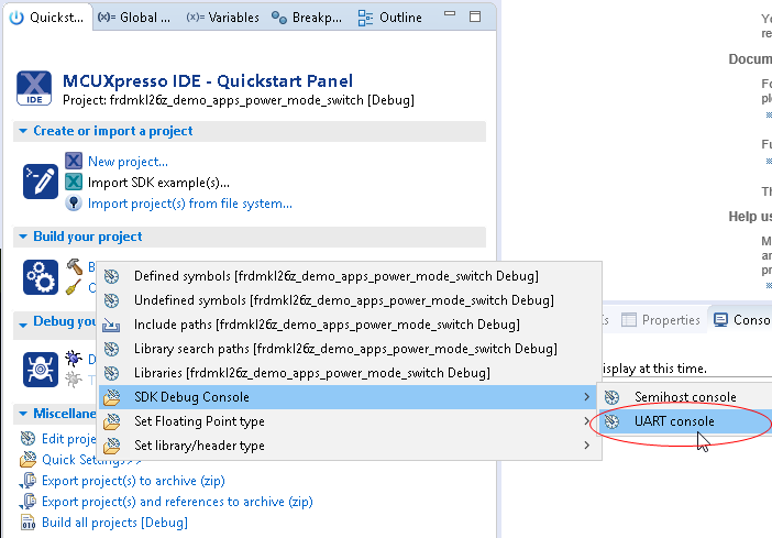

Hi , I am using MCUXpresso 10.1.1 and 10.2.0 using MCUXpresso SDK 2.2 for FRDM_KL26Z Board . I am trying out the demo_apps_power_mode_switch and have configured it to output debug print message thru UART .
It does not print out . I think there is something wrong with the toolchain . I have tried the hello_world and it is OK .

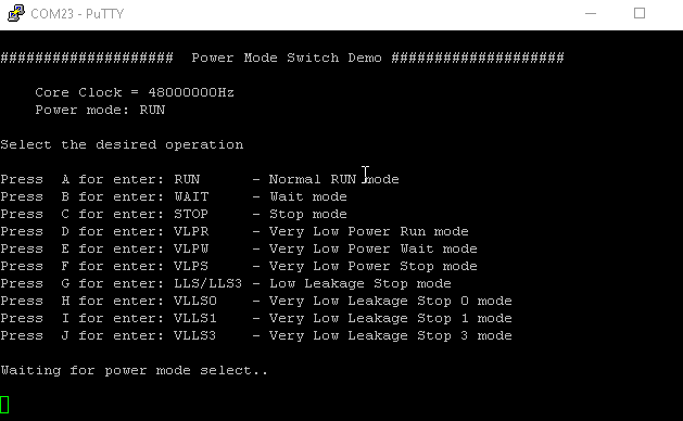

What about the baund rate you configure on Hyperterminal ? Please make sure it should be 9600.
I test on MCUXpresso IDE v10.2.0, FRDM-KL26 board, it can work well :
- Also make sure choose "SDK Debug Console"( while I think you should choosen it , as the hello world has work well).

Hi Thing Piao Chew,
I'm afraid I also don't know why this demo use 9600, maybe related to low power mode, I guess.
And please have a look at readme.txt when there is problme when run example.
