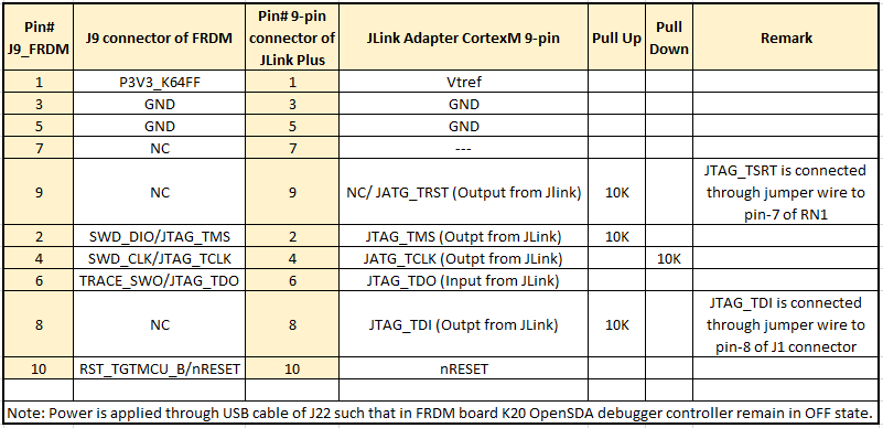

harsh_bhuva
Hi Erich Styger,
We have successfully able to load FRDM-K64F target MCU via JLink plus debugger with SWD interface using MCUexpresso. But we are not able to do it with JTAG interface.
Below is connection between FRDM_K64F and JLink Plus debugger:
Please suggest your view on this.
Harsh Bhuva

ErichStyger
Specialist I
Is your K64F enabled for JTAG signals? Note that the JTAG pins can be disabled to only use SWD.

harsh_bhuva
Hi Erich,
Whether FRDM-K64F is normally dispatched with JTAG disabled? If yes how to enable the JTAG pins for the same.
We are not doing any configuration to make JTAG and SWD enabled or disabled.
