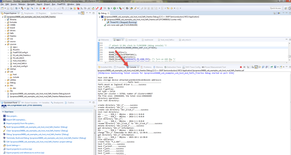

For LPCXpresso54608 please check prints in the console

Sorry for my delay. Unfortunately I cannot to reproduce your issue. Attached to this thread, I am sending a video with my test. In addition please look the below pictures where you can check the jumper configurations. Please try erasing the project from MCUXpresso and follow the video.
