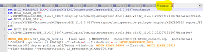

I followed this training video from NXP website: Getting Started with IMXRT685-AUD-EVK Development Platform
When I try to run an example code such as it, I continual encounter the error like:
15: Target error from Commit Flash write
Ep(04). Cannot halt the processor.
Debugging context: evkmimxrt685_dsp_mu_polling_cm33 LinkServer Debug

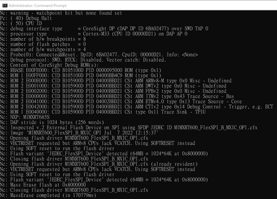

It can't enter the debug mode (but build successfully) and running failure, I had tried to erase the chip by GUI flash tool but got the same result. (both erase by IDE and terimal)
How can I solve it?
My environment:
SDK_2.12.1_EVK-MIMXRT685
MUCXpresso IDE v11.6.0
LPC-link2 CMSIS-DAP V5.224

How about change to a new workspace of MCUXpresso IDE, and import a simple demo to debug?
