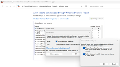

chaehee
All of sudden, same issue happens again after rebooting my PC.
I tried all previous comments, but it is not fixing issue.

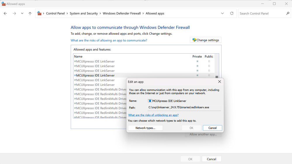

So, I uninstall all MCUXpresso IDE, I remove firewall setting too. I reboot my PC.

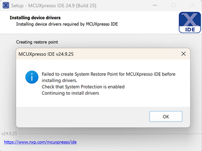

After rebooting my PC, I install MCUXpresso IDE. I got below error in the middle of installation.
I clicked OK and installation was finished. It's not asking reboot the PC.
After installation complete, it runs MCUXpresso IDE. It is asking firewall settings, and I allowed it.
I built project and started debugger. It is asking firewall settings again, and I allowed it too.
The IDE still not finding target device.

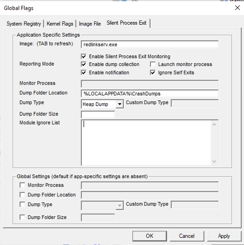

radu_lazarescu
At the time when the exit happens, redlinkserv is not doing any active work that might trigger a crash (and there is no crash report), it just sits waiting for connections or user input.
Based on this, I suspect that redlinksev.exe is being terminated by another process (Internet security software, firewall, etc).
One way to find out would be to use a Windows facility to monitor Silent Process Exits.
The Debugging Tools for Windows includes a GUI utility called GFLAGS.EXE
https://learn.microsoft.com/en-us/windows-hardware/drivers/debugger/gflags
This may be used to monitor Silent Process Exits
To enable this functionality:
  1. Run GFLAGS.EXE (as Administrator)
  2. Go to Silent Process Exit tab
  3. Type redlinkserv.exe and hit TAB
  4. Tick (at least) the following checkboxes: Enable Silent Exit Process Monitoring, Enable Notification, Ignore Self Exits (optionally fill the other options as below)
  5. Click OK to save and exit.
(A detailed description for all the available configuration options can be found here: https://docs.microsoft.com/en-us/windows-hardware/drivers/debugger/registry-entries-for-silent-proce...)
The changes are applied immediately for any new processes (reboot is NOT required).
Then try executing redlinkserv.exe --commandline from a command prompt.
If another process forces termination redlinkserv.exe, the offending process name is listed in a notification popup and in the application event log. (Optionally crash dumps are saved if enabled).
This might give us a good idea of what’s happening on your system.
To undo the effects of silent exit monitoring, run GFLAGS.EXE again, type redlinkserv.exe then hit TAB and uncheck all the boxes previously configured.
7,019 Views

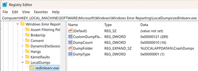

chaehee
I installed gflags.exe, ran gflags.exe, and set up silent process exit as your description.
First, I run "redlinkserv.exe --commandline" but no event log generated.

Second, I set up gflags.exe without "Ignore Self Exits" and save it.
I run "redlinkserv.exe --commandline" and event log generated. It means redlinkserv.exe was not crashed.
C:\nxp\LinkServer_24.9.75\binaries>redlinkserv.exe --commandline
redlink>
C:\nxp\LinkServer_24.9.75\binaries>dir %LOCALAPPDATA%\CrashDumps
Volume in drive C is Windows
Volume Serial Number is 602D-1572
Directory of C:\Users\chwon\AppData\Local\CrashDumps
11/15/2024 10:14 AM <DIR> .
10/11/2024 09:33 AM 415,521 hp-data-retriever.exe.16996.dmp
10/10/2024 08:47 AM 414,881 hp-data-retriever.exe.21200.dmp
10/10/2024 08:24 AM 428,029 hp-data-retriever.exe.22508.dmp
10/18/2024 08:41 AM 435,125 hp-data-retriever.exe.9260.dmp
11/15/2024 10:14 AM <DIR> redlinkserv.exe-(PID-3780)-73688359
11/13/2024 03:20 PM 22,487,628 TrueImage.exe.18060.dmp
11/14/2024 10:08 AM 22,511,620 TrueImage.exe.19728.dmp
11/13/2024 03:24 PM 22,487,859 TrueImage.exe.20004.dmp
11/14/2024 10:23 AM 22,468,424 TrueImage.exe.20236.dmp
11/14/2024 10:38 AM 22,473,454 TrueImage.exe.24412.dmp
11/14/2024 10:02 AM 22,495,977 TrueImage.exe.26980.dmp
10 File(s) 136,618,518 bytes
2 Dir(s) 1,531,353,182,208 bytes free
I attached event log file.
Let me know if you need more information.

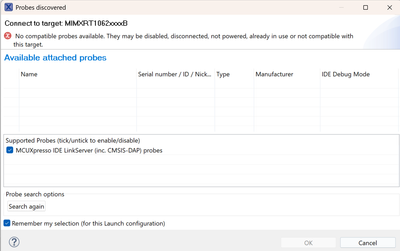

chaehee
Hi Mayliu,
For your information, I don't have old version of MCUXpresso on my machine.

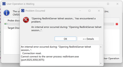

As you suggested, I deleted my workspace directory, and I created new project by importing SDK example. So, there is no .launch file. I built project successfully. I tried to debug but I got below error first.
Later I got below error.
I clicked OK button, and I got below -- it could not detect target device.
I checked the device manager, and I found target device is enumerated correctly.
Chaehee

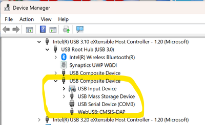

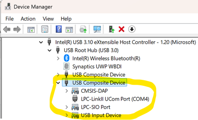

chaehee
Hi Radu,

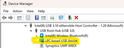

I put jumper in J12. I got below in device manger after power cycle.
I run Debug on the IDE. It looks like IDE switch mode, and I got below in the device manager.
But IDE still could not detect (or connect) target device. Error message is almost same as previous. It looks like same problem still exist with LPC-Link2 firmware. Any comments?
Do I need to replace the DAPLink firmware with LPC-Link2 firmware using LPCSCrypt (https://www.nxp.com/LPCSCRYPT)?
Chaehee

Thanks for providing the info.
It looks like redlinkserv.exe is crashing on your system for some reason.
Do you get a crash dump file created in %LOCALAPPDATA%\CrashDumps?
If you don’t, please enable crash dump collection (https://learn.microsoft.com/en-us/windows/win32/wer/collecting-user-mode-dumps)
(add a key HKEY_LOCAL_MACHINE\Software\Microsoft\Windows\Windows Error Reporting\LocalDumps\redlinkserv.exe)
Please send the generated dump file after a crash: redlinkserv.exe.*.dmp

chaehee
I added registry key as below, but it is not generating crash dump.

radu_lazarescu
Could it be that the process is being blocked by the firewall (or other Internet Security solution that you may have active on the system)?
Usually the first time you run MCUXpresso IDE you get a few prompts by the firewall to allow incoming network connections for various processes used in the debug stack (including redlinkserv.exe). Accepting it should add exceptions in the firewall for the specified processes. For example this is how it looks on Windows Defender Firewall
Is there anything logged in Event Viewer in Windows related to redlinkserv.exe process?
7,501 Views
chaehee
I just realized that below message was not posted due to error. Anyway, I am adding message again.
I allowed all network connections when I run IDE first time.
I also disabled all firewalls, but result is same.
I think next step is reboot my PC and check it again.
