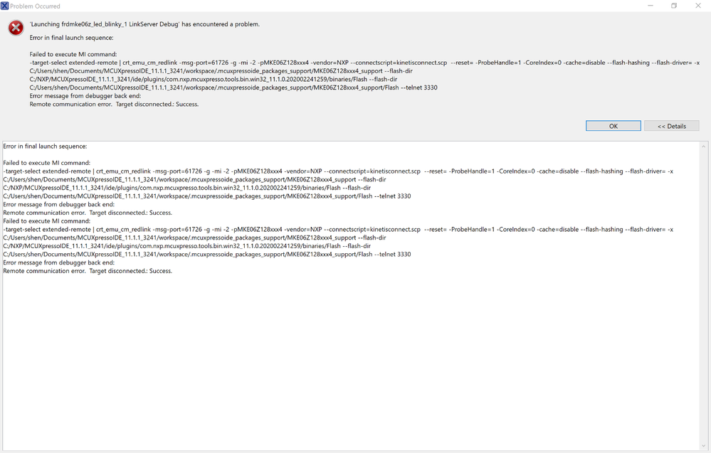

I just install the latest MCUXpresso IDE (MCUXpresso IDE v11.1.1 [Build 3241] [2020-03-02]) on my 64bits win10 surface pro 4. And importing a SDK sample for FRDM-KE06Z board, then make it is OK, but when I debug it I got the problem as picture show. And for check the hardware problem, I used KDS ( installed the same computer) to make a sample for same board, it is OK for the debug. Could you advise me how to fix this problem? Thanks.

Here is the result. PE Micro V118 has the same problem as above;  OpenSDAv1 ( download from https://www.nxp.com/assets/downloads/data/en/reference-applications/CMSIS-DAP-OpenSDA.zip ) only has about 32KB size of CMSIS-DAP_OpenSDA.S19, I am not should that is the correct firmware which has the problem MCUXpresso IDE both of win10 and linux platform( see the following pics ). The Jlink V1 ( download from https://www.segger.com/downloads/jlink/OpenSDA_FRDM-KE06Z ) is worked OK on MCUXpresso IDE.
Console information:
MCUXpresso IDE RedlinkMulti Driver v11.1 (Feb 24 2020 13:54:38 - crt_emu_cm_redlink build 11)
Found part description in XML file MKE06Z4_internal.xml
Reconnected to existing LinkServer process.
============= SCRIPT: kinetisconnect.scp =============
Kinetis Connect Script
Connecting to Probe Index = 1
This probe = 1
This TAP = 0
This core = 0
DpID = 0BC11477
Assert NRESET
Reset pin state: 00
Power up Debug
MDM-AP APID: 0x001C0020
MDM-AP System Reset/Hold Reset/Debug Request
MDM-AP Control: 0x0000001C
Flash Not Ready
============= END SCRIPT =============================
Probe Firmware: OpenSDA CMSIS-DAP (Keil Software)
Serial Number: A000000001
VID:PID: C251:F002
USB Path: \\?\hid#vid_c251&pid_f002#6&12939929&0&0000#{4d1e55b2-f16f-11cf-88cb-001111000030}
Using memory from core 0 after searching for a good core
Cannot halt processor
Request debug reset of DAP
( 40) No Halt
debug interface type = Cortex-M0+ (DAP DP ID 0BC11477) over SWD TAP 0
processor type = Cortex-M0+ (CPU ID 00000C60) on DAP AP 0
number of h/w breakpoints = 2
number of flash patches = 0
number of h/w watchpoints = 2
Probe(0): Connected&Reset. DpID: 0BC11477. CpuID: 00000C60. Info: <None>
Debug protocol: SWD. RTCK: Disabled. Vector catch: Disabled.
Content of CoreSight Debug ROM(s):
RBASE F0002000: CID B105100D PID 000008E000 ROM (type 0x1)
ROM 1 E00FF000: CID B105100D PID 04000BB4C0 ROM (type 0x1)
ROM 2 E000E000: CID B105E00D PID 04000BB008 Gen SCS (type 0x0)
ROM 2 E0001000: CID B105E00D PID 04000BB00A Gen DWT (type 0x0)
ROM 2 E0002000: CID B105E00D PID 04000BB00B Gen FPB (type 0x0)
Failed on chip setup: Ep(04). Cannot halt processor.

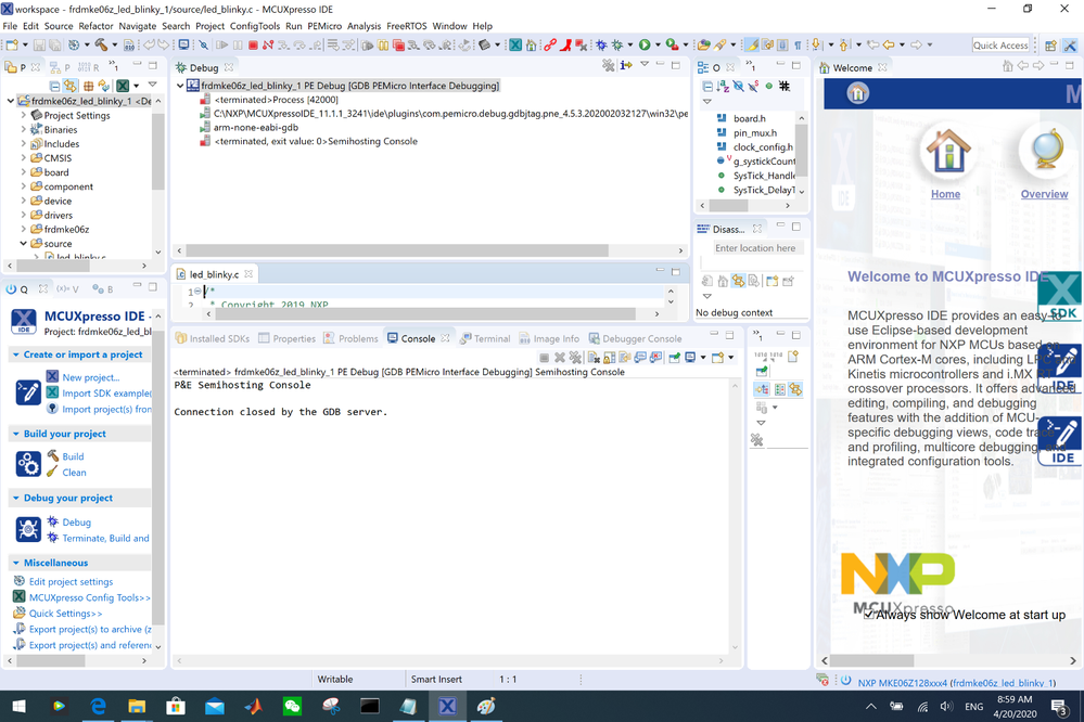

renlei
Hi Diego

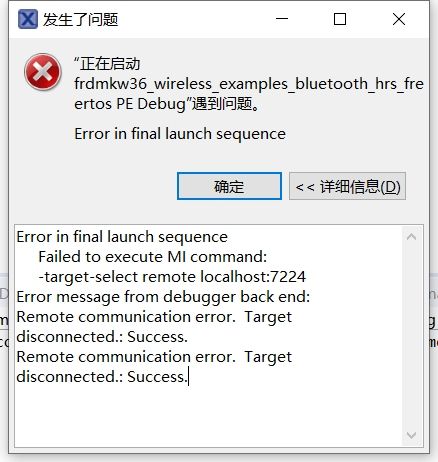

I have encountered some problems when using frdm-kw36, and I need your help.When I use LS or PE debug, the MCUXpresso IDE prompt is shown in the figure.The figure  shows debug using PE.But I was successful in erasing and programming frdm-kw36.Just debug doesn't work.pastedImage_5.pngPE.jpg

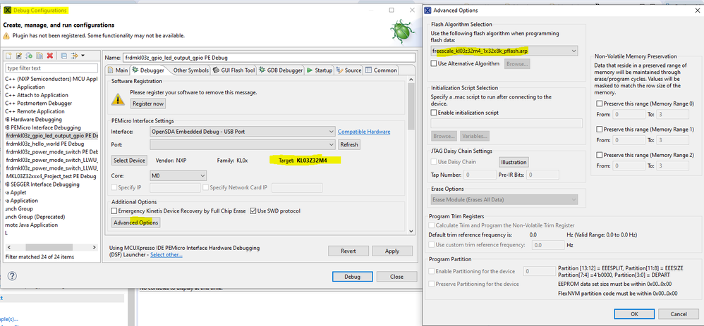

It seems that the error  Target remote localhost:7224 appears if the GDB server cannot be found or if there is something wrong on the launch configuration.
You may already have found and test some of the following recommendations , but I will summarize them:
For example with  PEmicro, check  to have proper target (in my case KL03Z),  and flash algoritm:
Coul you help me with the following inquiries:
  1. Were you able to debug previously, using the same MCUxpresso  and driver versions?
  2. Besides the other recommedations on thist  post,  there are other recovery paths you evaluated previously without sucess?
Best regards, Diego.

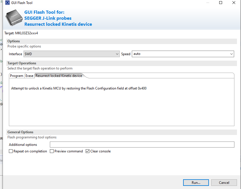

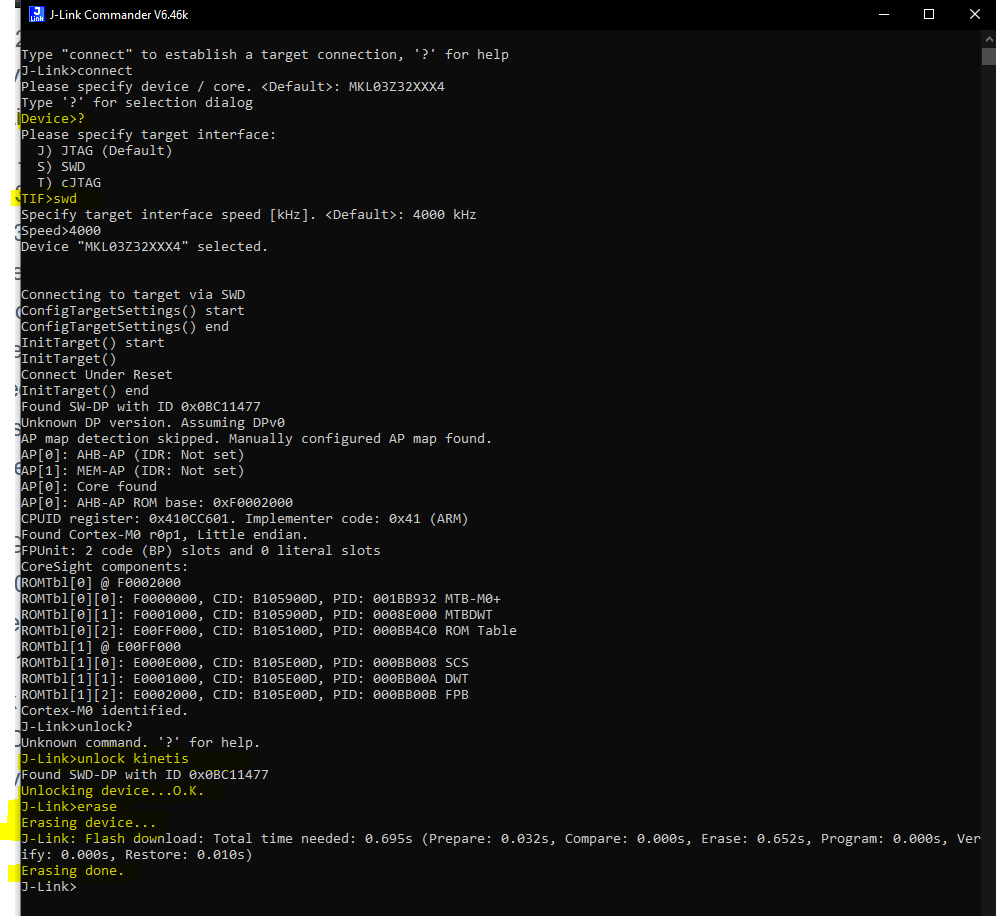

First , make sure that the board is not bricked  by  erasing  the board  K20 debug probe and then loading the binary file. For this an external debug probe is required. For details on this go to   Freedom OpenSDA Firmware Issues Reported on Windows 10.
Then ,  try to  check if you are able to perform and erase on the target MCU (KW36) . Here are two ways for doing this:
  •  A) In MCUxpresso, go to GUI flash tool and go to Resurect locked device, then  erase the flash memory.
  • B)  Use J-link commander and connect to the target (KW36), then use commands unlock kinetis and erase
If you are not able to perform this, please let me know.
Diego
3,836 Views

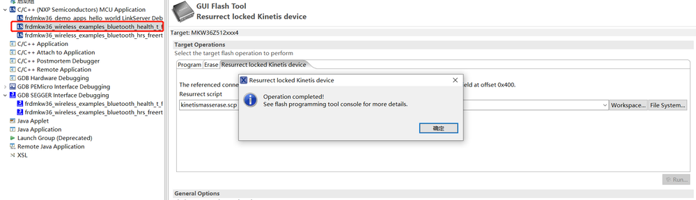

renlei
Hi Diego Charles
Thanks for your reply!
When I use LS, I can Resurect locked device& erase, but when I use Jlink, I cannot Resurect locked device.I also tried Jlink commander, but I still couldn't connect to core.And no matter what method I use, I can't debug.

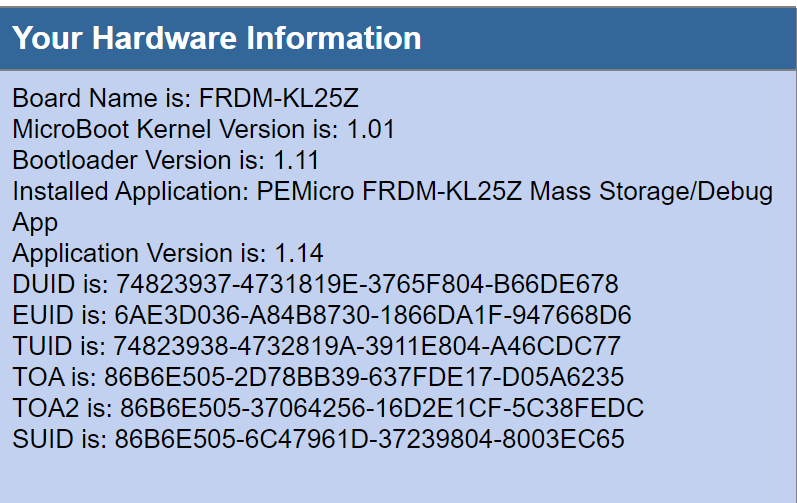

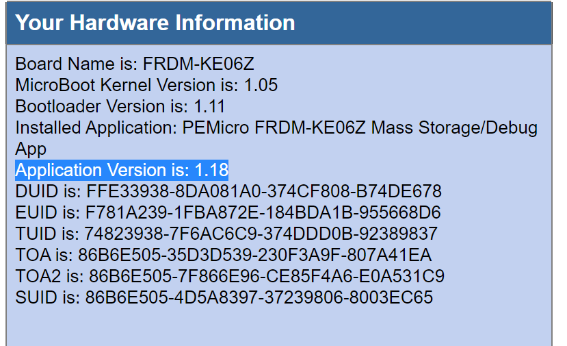

zhongshen
Thanks for you comments.
Delete all launch configurations, and using blue Debug button to start debug. The problem is still existed even reinstall IDE again!
And I try to use a example in SDK for FRDM-KL25Z board, it is OK to launch debug. The OpenSDA version is different: Application Version is: 1.18 on FRDM-KE06Z board and Application Version is: 1.14 on FRDM-KL25Z board.
On linux desktop, MCUXpresso 11.1.0 is OK to launch debug for FRDM-KE06Z board. It is only in windows MCUXpresso 11.1.1 could not launch debug for FRDM-KE06Z board.
