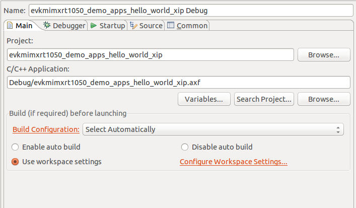

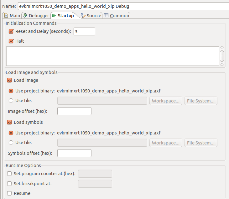

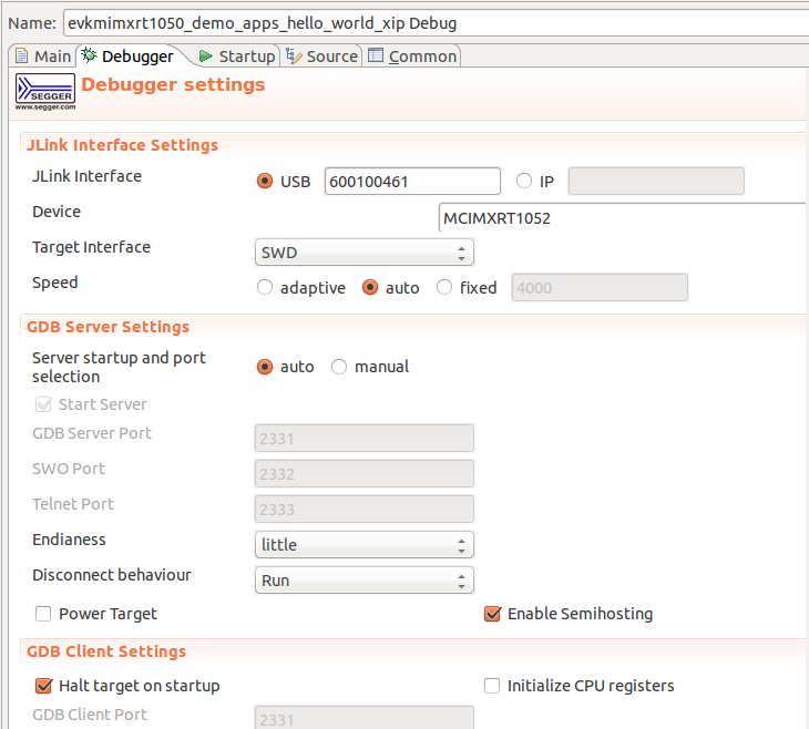

Here is my J-link setup:
The "Source" and "Common" tabs are in their default state.
Any insight into the j-link error would be appreciated, thanks.

ryanshuttlewort
Fixed, you have to right-click on prroject -> Launch Configurations -> Create New -> Segger J-Link Probes (or what ever your new probe is).  All subsequent debug attempts will use that config. until changed again.
Do not attempt to create launch configurations manually, this just leads to unusual issues.

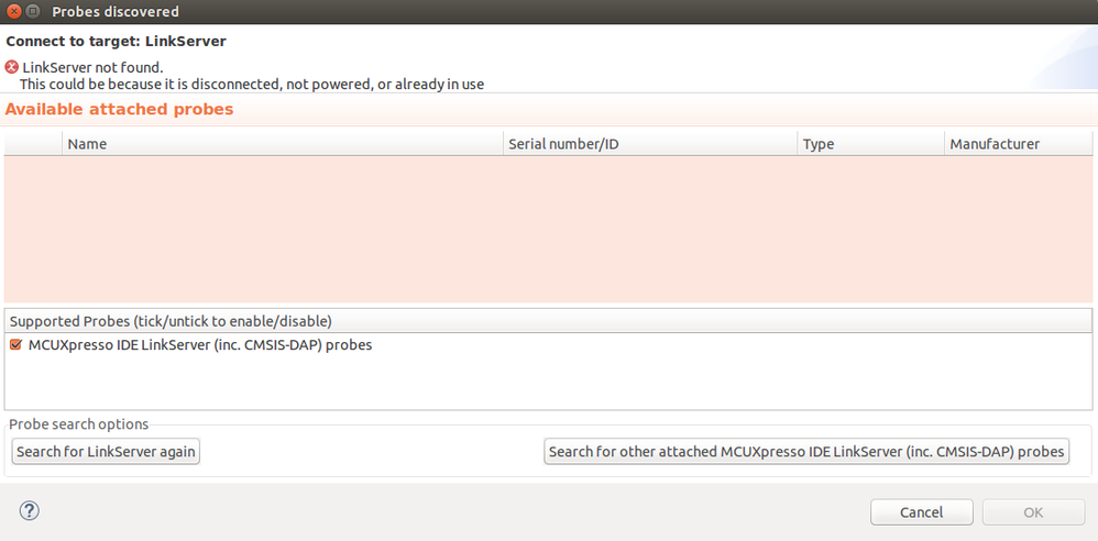

ryanshuttlewort

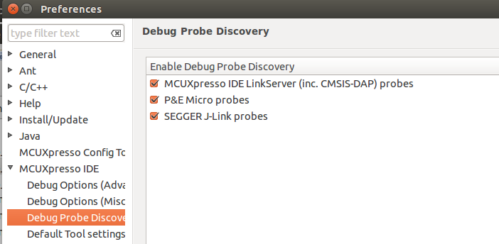

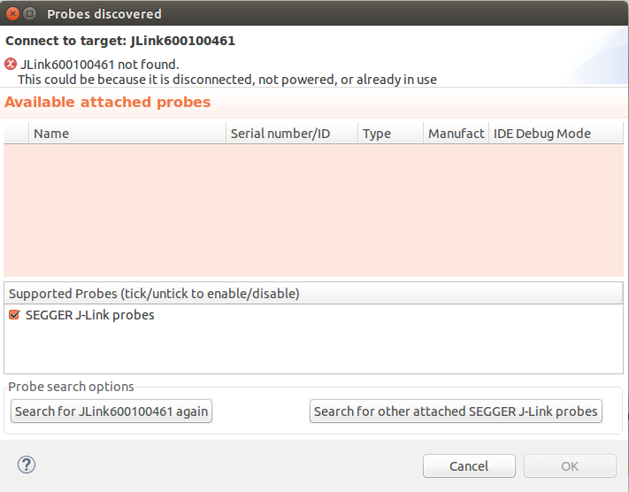

An update on the original issue.  There appears to be a bug or "feature" in the IDE such that if J-Link is not present on the very first debug attempt (blue bug button press) you will never be given the opportunity to add j-link again during the probe discovery process on subsequent debug sessions.  The following images demonstrate this.
This is the menu I see on a project where J-Link was not used on the very first debug, as you can see there is no J-Link or P&E Micro probe search options, only CMSIS-DAP probes even though a J-Link probe is present on the system:
The above menu options appear even though auto-discovery of other probes seems to be enabled:
Now, if the project is completely deleted and re-imported but this time with a j-link probe attached I get the following screen:
However, once J-Link is selected I never again get an option to use other probes like CMSIS-DAP even though one is attached:
This behavior seems to be present on OSX and Linux.
Any ideas how I can get around this without deleting an existing project?
