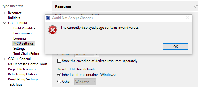

I have installed MCUXpresso 10.2.0 and after that I removed 10.1.1. Now all my projects complains that project properties cannot be changed. I imported some kw41 connectivity sw example project and while I was browsing the code I realized that there were no MCU selected (???). I went to project properties of that project to change the MCU but it was broken. In fact every other projects had that symptom also.MCUXpressoFailure.PNG
The other project has Project Settings OK and it builds, but I am not able to change MCU settings. Maybe reverse installation and VCS restore version might help.

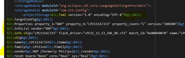

BTW, I looked .cproject-file and looked like this:
Not sure if that is right but it makes you think. The XML export looks like that only in TargetConfig section which might be "MCU settings". In addition that "xml version..." is not where it should be...

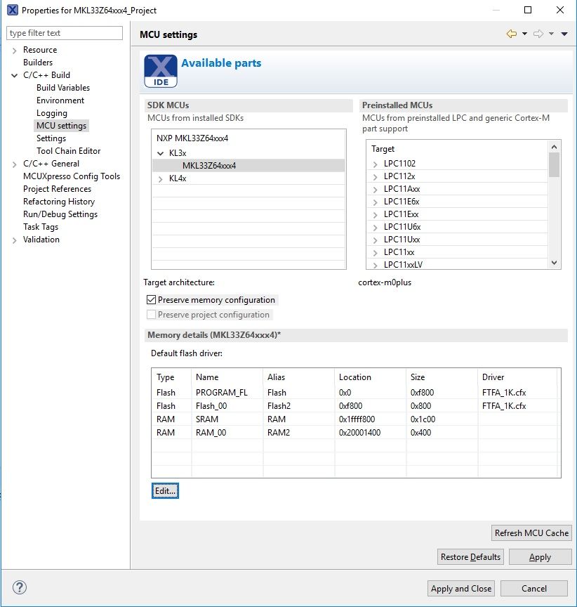

luca_securo
Hi I have the same problem of Darius.
I just uploaded MCUXpresso to the new version v10.2.1_795.
I modified the MCU settings, adding FLASH, RAM, clicking outside the modified cells, click Generate and OK.
Then "Apply" and "Apply and Close".
I closed and opened my project and I lost all MCU settings.
Why?
Luca

luca_securo
Hi Erich,
   I have Windows 10 too.
Maybe can you tell more what you mean with 'clicking outside the modified cells'?
I meant that I did what was writen in section 16.8.1, "Editing a Memory Configuration" of the MCUXpresso IDE v10.2 User Guide ...
 "once a change has been made, ensure a mouse click is made outside any changed cell, this action will force the change to be recognised by Eclipse"
See these screenshots, I hope it helps.
Note that I do this becouse I'm working about Erase/Write/Read data in flash memory passing throught the Ram memory.
Luca

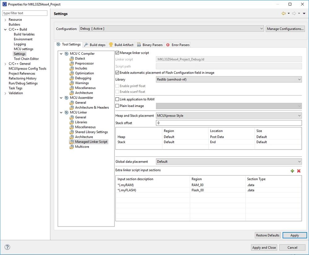

BlackNight
Hi Luca,
ok, I see: that click-outside is simply if you modified a cell, then you have to exit that cell to take the value.
I tried again to reproduce things on my side, and that extra Flash and Ram sections I have added are still visible and stored.
What is the purpose of your seconde (linker page) screenshot? To show that you have managed linker scripts enabled?
Just another thought: you have your project on a normal drive on your machine, right? I have seen reports about problems if that project is say on a driver/location shared with DropBox or similar.
I hope this helps,
Erich
3,513 Views
luca_securo
Hi Erich,
Thanks for the quick answer!
Did you try to close and open your project too?
Exactly.
If I close and open my project the linker settings still stored but the table of MCU setting return to default...It's strange.
For now I continue to develop my software reminding myself never to close my project.
PS: My project is in my own machine.
Luca
3,513 Views
BlackNight
Hi Luca,
now I'm able to reproduce it. I'll report it to the development team.
Thanks!
Erich
PS: I was only able to reproduce this with 'Extra linker script input sections' added to the managed linker scipt settings.
3,513 Views

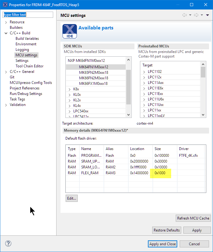

BlackNight
Hi Darius,
I'm not able to reproduce this, it works properly for me with pressing Apply and/or Apply&Close (at least under Windows 10).
I changed the value marked in yellow below, and it has been stored to the project files properly.
Maybe you could provide more details?
Erich
