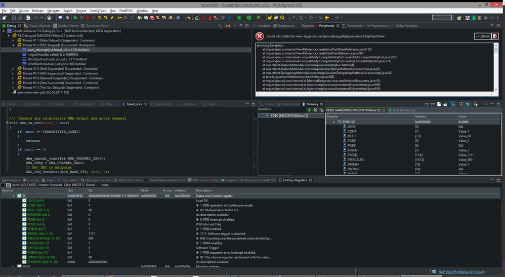

I just discovered the hover thing too - turns out a bunch of the fields DO have useful descriptions, but they're only visible as tooltips!  Which are placed UNDER the mouse pointer, so there's always a part that's blocked from view.
If I debug with my Cyclone, PDB0:LDOK shows up with a value of 0x2, as does SWTRIG.  These are both 1-bit fields.  Nothing else changes between runs, but with an LPC-Link2 the values show up as 0, like they should.
Decoding registers is one of the basic things I expect from an embedded IDE and I can't believe it's this frustrating to get working right in MCUX.  Here's one screenshot that shows the Peripherals view (doesn't work at all, was just enabled by default), the Peripherals+ view (with the hover descriptions) and EmbSysRegView, which is working pretty well now, except the repository has been broken for months (years?) and you have to jump through hoops to install it.
