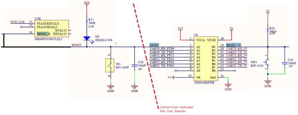

Although, please let me share another aspect regarding this issue. I went a bit further on the schematic, following the reset line and found that my LED and 300 Ohm resistor were in fact in parallel with an 4k Ohm pullup resistor inside a level shifter. Let me explain: We have the main board with the MK64 Kinetis and its reset cluster of LED, 300 Ohm resistor and button to ground. Then this main board is connected to a second board with another reset button and pull up resistor of 50k. But this second button is driven by the 5V rail so it is passing through an level shifter from 5V to 3.3V before connecting to the main board. This level shifter (TXS0108) has an pullup resistor of 4k when driving high. So I think that in fact our micro controller have the reset pin connected to a parallel of a 4k resistor with a series of LED and 300 Ohm resistor.

Could you provide me with a schematic of the reset circuitry?
As a hard rule, you should not have any push-pull drivers on the reset line - there should only be a pull up along with open drain/collector outputs or a normally open switch (as you have) pulling reset to ground on the line.  This is normally called a "dotted-AND" bus and has a pull up and multiple devices which can pull the line low without driving current onto it.  The most important reason for keeping current drivers off the line is to allow debuggers to be used in the circuit.

joao_ribeiro
Hello Mike, thank you for your reply and help,
I am attaching the reset portion of our schematic as you asked (the doted line represent the connection between the two boards; board with Kinetis micro controller and the second board with the level shifter)
Unfortunately we will not be able to change the board with the level shifter, therefore I think that the only change that we can make is swapping the LED for a 100k resistor in order to overcome the 4k resistor inside the level shifter (TXS0108). I have tested this hypothesis and it overcome the issue of being stopped at a power cycle.
After reviewing the schematic and the hypothesis tested, would you recommend any other precaution?

myke_predko
Senior Contributor III
Hi João,
Intteresting to see that the HSMG-C190 LED has a forward voltage of 2.2V which, when you take it away from 3.3V, it's 1.1V or Vaio(0.3V)+Vhysh(0.8V) which means that you're probably going to get the problem you describe.  This was pure bad luck.
As I said in my previous post, you shouldn't have multiple drivers on the reset (or any other) net.  If I were designing the system, rather than use a level shifter to pass reset from the +5V side to the MK64's side, I would use a non-inverting open collector/open drain output buffer like the ON NL27WZ07DFT2G (Link to Datasheet) - it's cheap and works with a wide variety of voltages.
You should probably get rid of the 100k (or 300Ohm+LED) pull up, the reset switch and cap on the MK64 side of the application and just take the reset signal from the other/main board.  There's a button on the +5V side so you just have one control of the reset signal - the issue is here is that during power up you have two drivers (the RC networks on either side of the level shifter) and you may get some strange power up/manual reset situations.  Just having one RC delay for reset (on the +5V side) will always give you a good power up.
