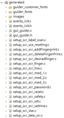

Initially, I used GUI-guider to design my user interface and exported the project to MCUXpresso for further design. However, I encountered a problem.
Now, I would like to add events to control component actions. Should I add event files in the source files or in the generated files or something else?
And what should I do first? I have limited knowledge of MCUXpresso IDE, but I have to use it for design.
would greatly appreciate it if someone could lprovide guidance.

Hello Yuan1,
You can add an event program to the "events_init.c" file.
If you want to add a new event, you can do this:
1. Add events to your GUI-guider project.
2. Re-generate the GUI-guider project program, after which the contents of the "events_init.c" file in the GUI-guider project will be updated, and the file will contain more event programs that you have added.
3. You can add events by comparing the updated "events_init.c" with "events_init.c" in your MCUXpresso project.
