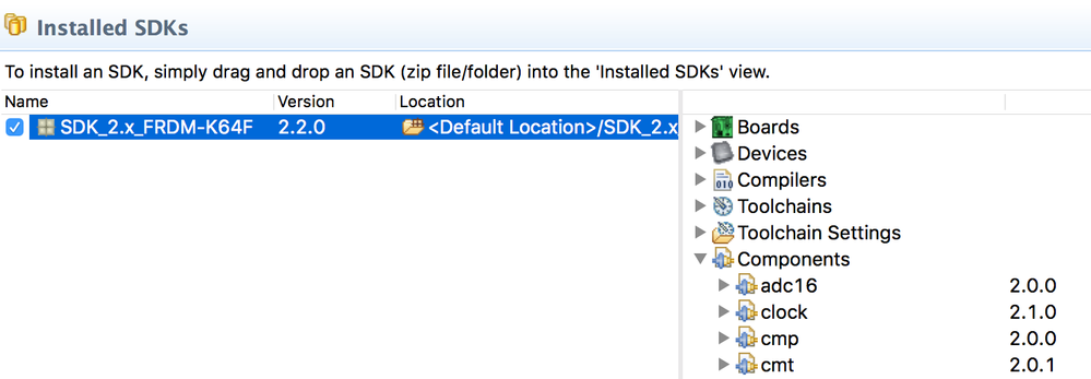

I have added the SDK in the zipped mode.
I created a new SDK project and added some of the drivers/components needed by the project.
But I haven't found the way to add a driver/middleware/component to the created project... I can see the content of the SDK in the Installed SDK's view, I can open the source, but nothing else..
I also tried with drag&drop ... nothing happens.

Hi Chad,
adding/removing components after project creation is not possible in the current version/release of MCUXpresso IDE v10.0.0, but is something considered for a next update. What I'm doing is to create a 'full' project on the side and then I can copy files over from the drivers folder.

Also found this topic when trying to add SDK drivers to an active Project.
After a bit of fiddling I found a solution:
  1. Right click on project in Project Explorer
  2. Select Import
  3. Under the General tab select File System
  4. New window will pop up with 'From directory' input box, select browse
  5. Browse to the folder containing the driver files (I had placed mine in the projects driver folder already)
  6. After selecting the source folder you'll get a set of check/select box options for all valid source/header files, check the ones you need
  7. Click finish
You might need to move them inside the Project Explorer tab to the correct directory (\drivers), you can do this by right clicking on the file and selecting move.

chadwingrave
I too came here to look for this. The Wizard allows for the addition of components (which create files in the drivers directory) but I haven't seen anyway to add/remove components after the creation of the project. In the meantime, I will look at the source of the files (i.e. expand the component and click on the files) and create those files in my drivers directory. Bummer there isn't some simpler approach.
