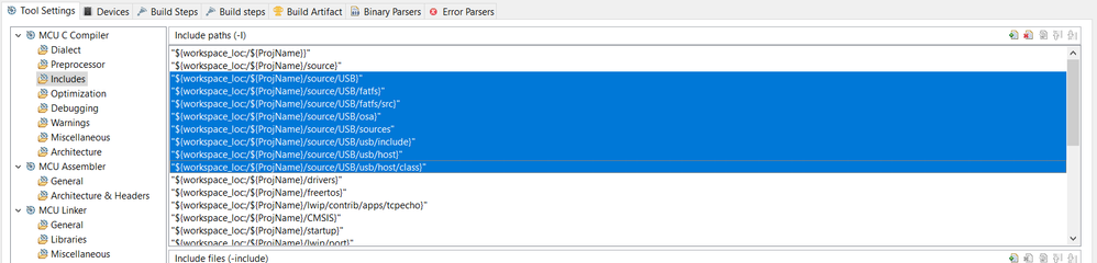

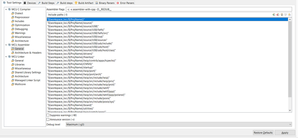

gustavocosta
Hello Alice_Yang,
sorry to bother you again.
Now I am trying to include the USB Stack from the example "USB Host MSD FATFS" provided by the MCUXpresso SDK, and I get the same problem.
Even after placing the code into my "source" directory I could not make it work. I must be doing something wrong. Bellow there is some pictures of what I am trying to do:

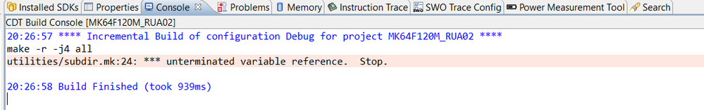

And this is the error I get:
20:26:57 **** Incremental Build of configuration Debug for project MK64F120M_RUA02 ****
make -r -j4 all
utilities/subdir.mk:24: *** unterminated variable reference. Stop.
But now I can't make the workaround I did last time because I've already have the lwIP included.
Hope you can help me.
