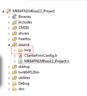

Hi Gustavo,
I don't know why it can't add new folder under the project , while I find a workaround ,
move the lwip folder under a existing folder, for example "source", then also change the path on
"MCU C Compiler -> Includes"
I  also attached your project after moving.
Hope it helps

I was able to work arround this problem by importing an example and turning it into my project, but I could really use a step by step guide on how to add stacks to a project.

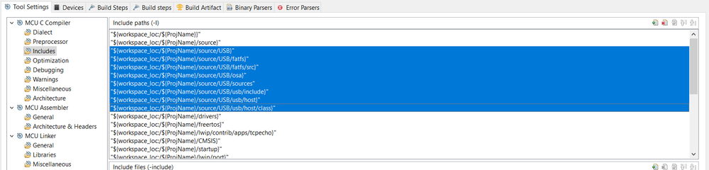

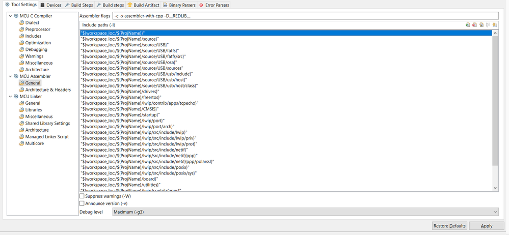

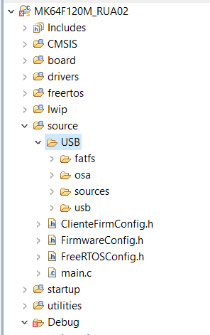

Now I am trying to include the USB Stack from the example "USB Host MSD FATFS" provided by the MCUXpresso SDK, and I get the same problem.
Even after placing the code into my "source" directory I could not make it work. I must be doing something wrong. Bellow there is some pictures of what I am trying to do:

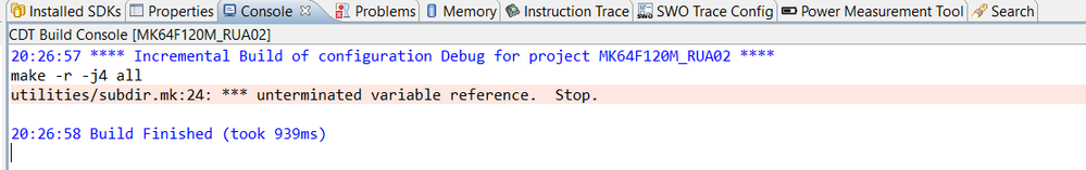

And this is the error I get:
20:26:57 **** Incremental Build of configuration Debug for project MK64F120M_RUA02 ****
make -r -j4 all
utilities/subdir.mk:24: *** unterminated variable reference. Stop.
But now I can't make the workaround I did last time because I've already have the lwIP included.
Hope you can help me.

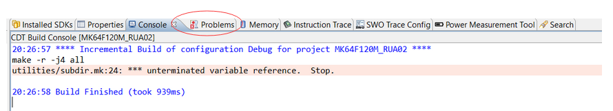

Hi Gustavo,
Please share the message in "Problems" view :
also send your project to me .
Sorry for the bad internet somedays ago , I just checked  this message haven't been send.
