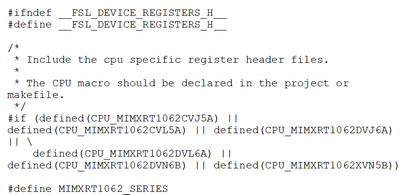

There isn't a special support for RT1060X.
If you look at RT1060X datasheet, you'll see their real name.
This has been added into fsl_device_registers.h

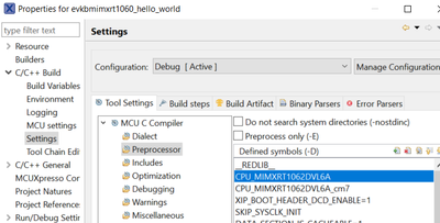

So, what need to do is changing the predefine in project properties.

That is true and we already did this. But to use the PinMux Tool inside MCUxpresso, this is not enough.
The processor type is not known by the PinMux Tool and a new SDK cannot be integrated because it seems the format changed and version 11.4.1 does not recognize them anymore.
