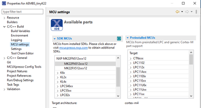

The 'normal' way would be to use a build configuration (see https://mcuoneclipse.com/2016/05/19/build-configurations-in-eclipse/ ) for each device variants, and you are done. Like it is for the build settings:
Unfortunately the MCUXpresso device and configuration tool settings are per project and not per Eclipse build configuration. It would need that same configuration drop down as above):
I could be that this will be implemented as feature in a future IDE version.
